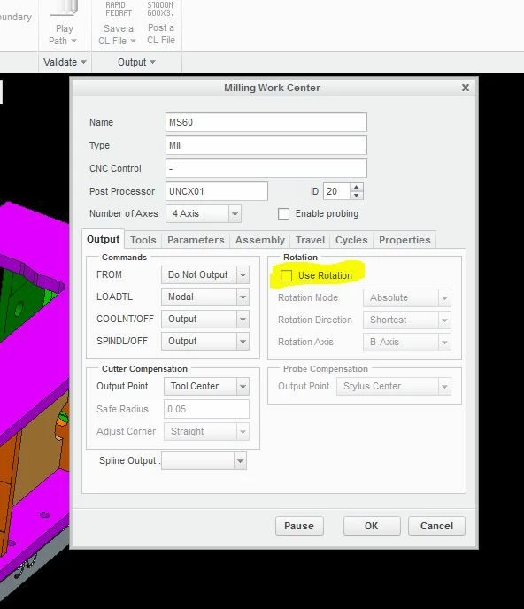

I have flipped every switch and configuration that I can think of trying to get Creo to output a negative B-axis movement.  The machine is currently set to shortest path in Creo, and has all the correct boxes checked (I have tried them all I am pretty sure) in GPOST, but no matter what I have tried, I am unable to get the "-" value in front of my B-axis movements in my generated code.
What am I missing?
This is our current FIL that was made for us, but even if I remove the FIL and run default GPOST, I still do not get the negative values for the table rotation.  The way our table operates, it has 0-360 and negative controls the direction.

nlehmanAnswer
Mar 8, 2018 4:38 PM UTC
Ken, thank you for your help.
I wanted to update this thread for other users with the solution.  I was not aware that Creo also has the ability to handle some post processing before handing it off to the actual POST.  In this case, creo was using ROTATE before then handing it off to the POST to further try to process, causing errors (I am not really sure what ROTATE is).
The solution was to turn off "rotation" in your work center portion of Creo which turns on MULTAX (another term I am not really sure of), this then hands off to the POST and allows the POST to calculate the B rotation without Creo's input.
So basically as I understand it, I was originally trying to calculate B movements with two different softwares touching it, that was the cause of error.  Thanks to Fred down at AustinNC for helping with this.
turn off rotation to turn on multaxturn off rotation to turn on multax
