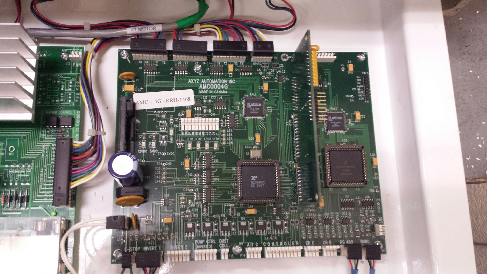

Hi David,

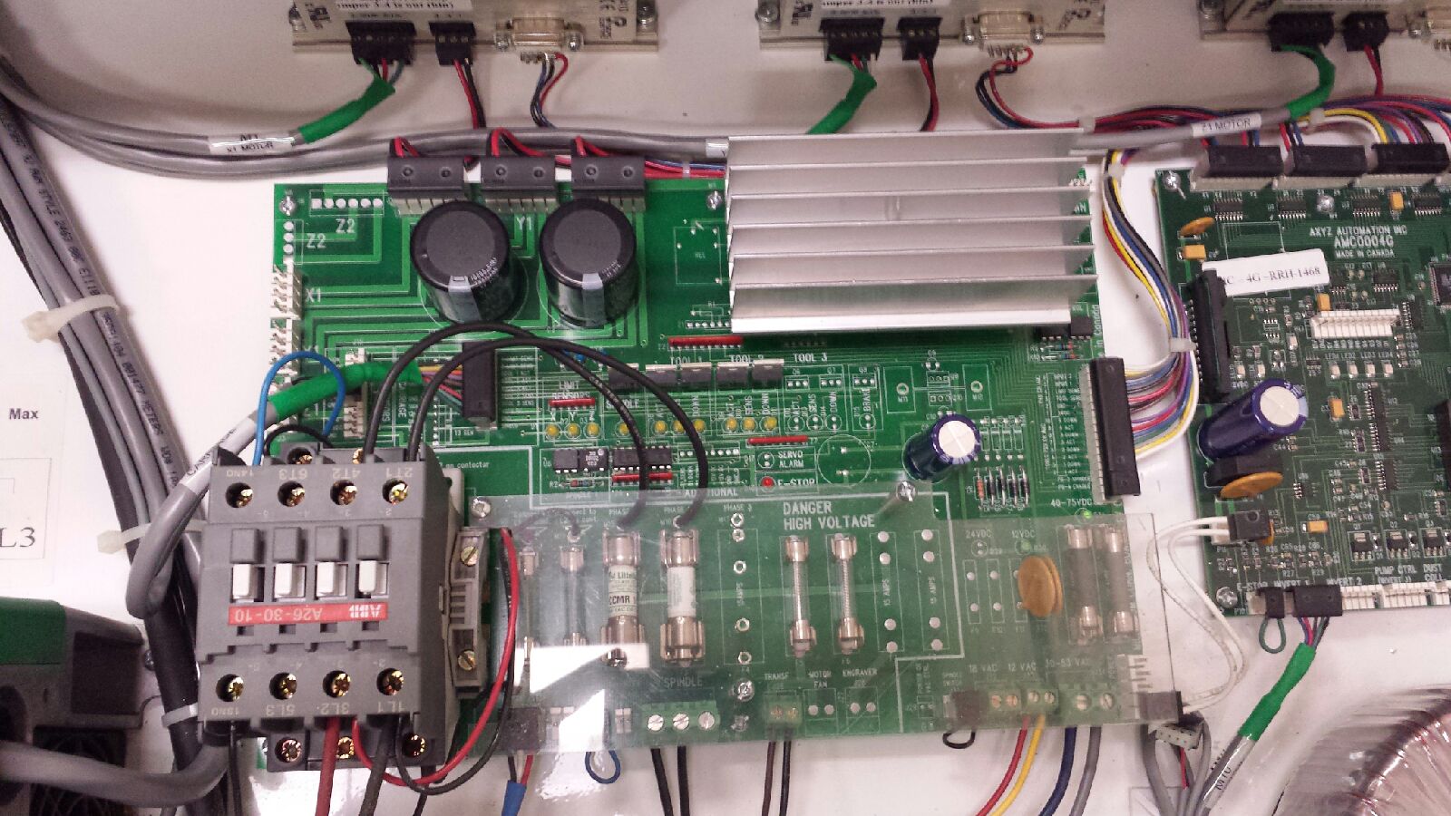

Thanks for the reply. I have more info for those that know more about this. I openned the machine up and saw what looked like a control board. AMC 0004G 4G RRH 1468
I am concerned with work flow. We have Creo 2.0, and hopefully 3.0 soon, on our labs computers. I would like to go from Creo right to the CNC Router machine.
There was a product called Pro/NC that I came accross from PTC; I am not sure if it still available to High Schools or if there is an updated version. We have a FIRST Team at the school so the machine gets used a lot during build season. Mentors that come in have mentioned we need to make the work flow better.
