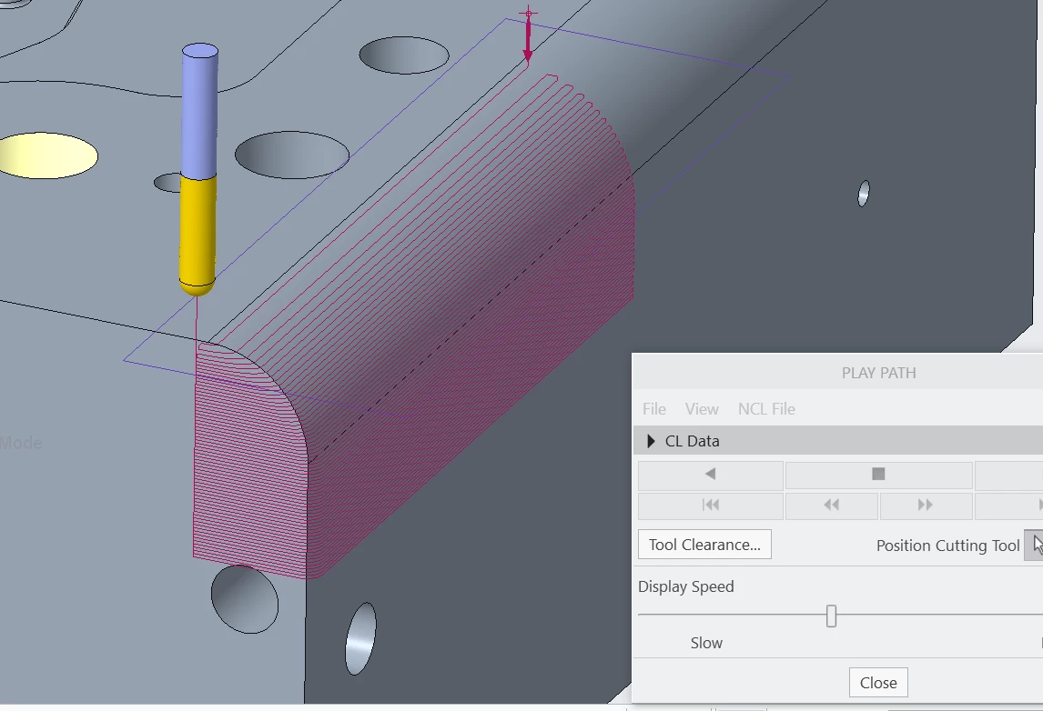

volume profile milling constant depth
  • July 31, 2026
  • 0 replies
  • 113 views
hello in Creo volume profile milling: why the step depth is not constant on radius profile like staight wall.please advice. also same problem in profile milling if use ball nose step depth not constant but if use endmill with scallop height then step depth change as per profile
regards
