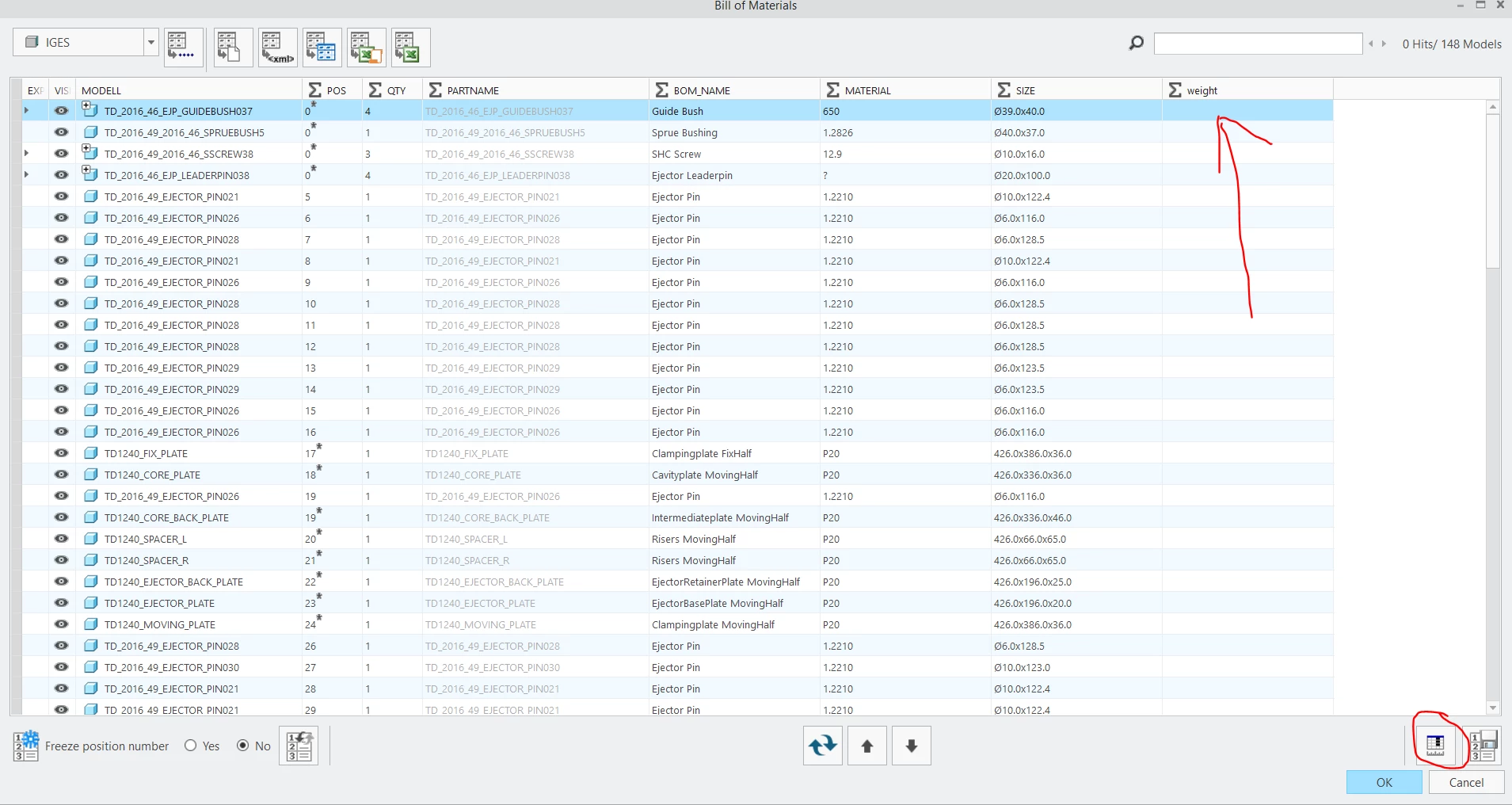

weight calculation in EMX component
I am adding a weight column in EMX BOM,
it is not getting the weight values even I refresh (Recalculate option) it.
Please find the attached screenshot.

@ICAD_Support
Try setting EMX config option RECALC_SIZE_WHEN_OPEN_BOM as Yes
