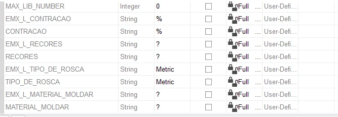

When creating parameters in project_parameters.cfg in asm parameters we have adicional parameter EMX_L_ why?
  • May 10, 2017
  • 2193 views
Parameters on fie project_parameter.cfg:
! NAME BELONGS_TO    PARAM_TYPE   FORMAT DESIGNATE        SHOW_TABLE SHOW_GUI USE_TO_SUM DEFAULT_VALUE
CONTRACAO PART     STRING 8 N Y Y N            %
RECORES PART     STRING 8 N Y Y N            ?
TIPO_DE_ROSCA PART     STRING 8 N Y Y N            Metric
MATERIAL_MOLDAR PART     STRING 15 N Y Y N            ?
See image attached, where are the parameters created on the asm, where you can find duplicated parameter whit prefix "EMX_L_" i think this shouldnt exist?
June 15, 2018
Hello croda-2,
this was a legacy feature. We do not write an read this parameters with our latest software release.
I am not aware what version you are using.
Kind Regards,
Thomas Schneyer
Development EMX at B&W Software
