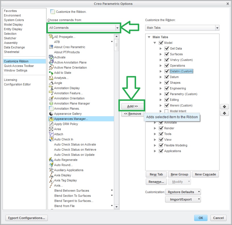

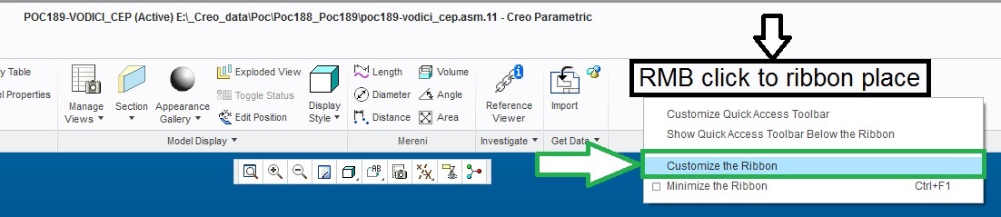

2-Explorer
Nov 11, 2016 1:54 PM UTC
Hello Rick Cordova
when the "icon" had not be placed in any of your ribbons, than search tool doesn´t work. Try use following method to make you sure, that desired icon is still present in Creo version you are using.
1. Go to "ribbons edit mode"
2. Search for desired icon/function and add it to desired ribbon
Hope you will find what you want...
Regards
Milan Bonka
rcordova10-MarbleAuthor
Nov 11, 2016 2:01 PM UTC
Milan, great Illustration, however this method still does not show "custom trajectory" button that the help center talks about.

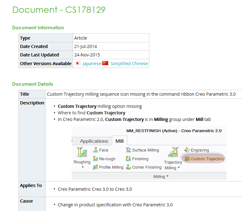

rcordova10-MarbleAuthorAnswer
Nov 11, 2016 3:47 PM UTC
Ok folks I found the solution at PTC tech support.

Nov 14, 2016 10:27 AM UTC
hi
You must add config.pro option: classic_milling yes
