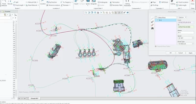

Sorry in advance if this looks confusing but I'm wondering if someone can shed some light on this. Looking to route a wire from off the screen at the top left to the center of the picture (where the wire is currently going) is there a reason it's not following the remaining section of the network (in black) to get to the connector?
My only guess as to why it's doing what it's currently doing is because  the intersection where it should go is to tight of an angle based on the bend radius of the wire.
If that is the problem is there a better way of fixing it besides adding more points in my network? Really wish the network would be more straight lines and then let the wire dictate the curve.
