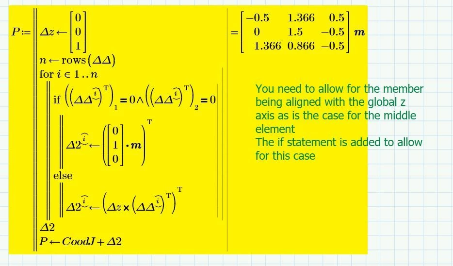

Have eliminated the error.
The case where the member aligns with the z axis needs to be taken into account.
Have added an if statement that defines this.
Cheers
Terry

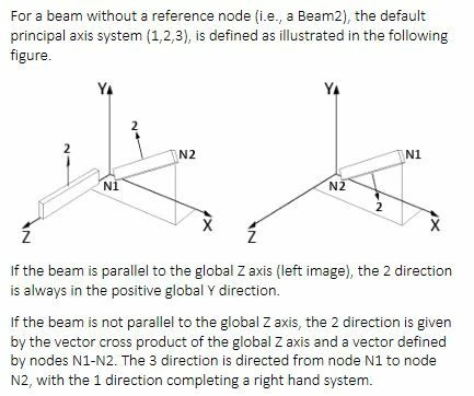

terryhendicott
Here is how a commercial piece of software defines P on the y(2) axis.
In the graphic axis 3,2,1 is the same as your local coordinates x,y,z.
x(3) local is along the member.
y(2) local is defined as Y global for beams parallel to Z global axis.
y(2) is defined by vector product of Z and 3 if not parallel to Z global
z(1) completes the orthogonal set.
Define y(2) as above and you can set P for your example.
Cheers
Terry

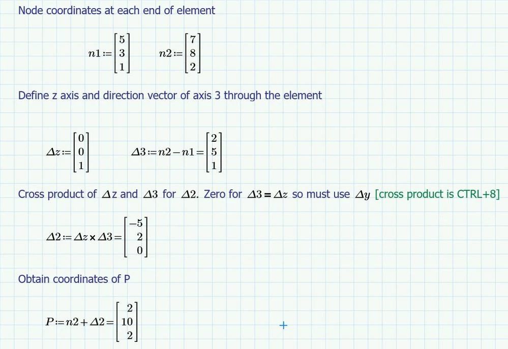

terryhendicott
Took time to show how to calculate P.
The case for element on z axis is trivial so not covered.
Cheers
Terry
Hello @terryhendicott
I got error when I apply my example
terryhendicott
Cheers
Terry
