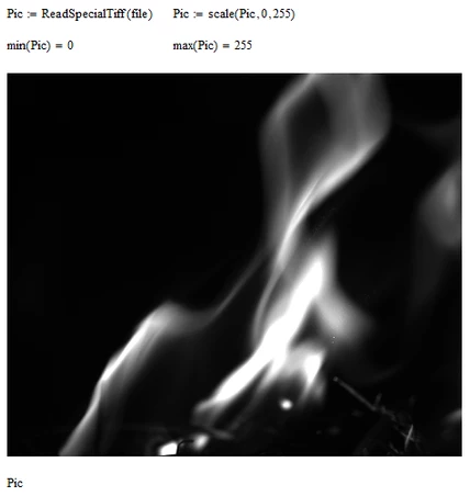

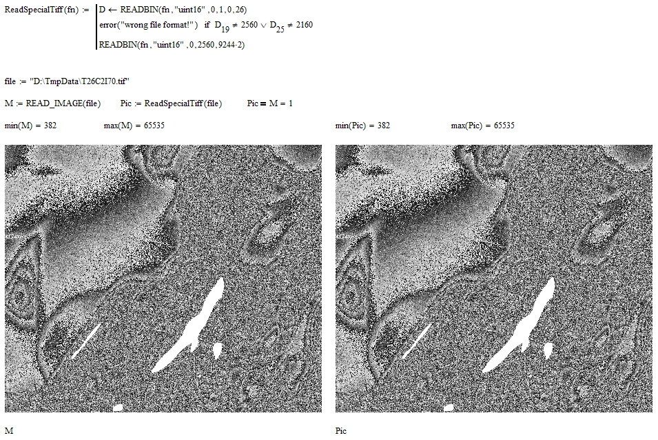

In case of the uncompressed TIFFs you posted, the data is there unchanged starting from word #9244 and so the pic easily can be read in in Prime and then turned into the proper matrix.
But you would have to dig into the specifics of the TIFF format to modify the function for pics of different resolution, etc. Its not a generic TIFF reading function!
The rudimentary function I provide will only work with pics of the very same format as the three pics you posted (uncompressed TIFF, 2160x2560, 16 bit, ...).
As we can see in MC15 the result is the same as when we use READ_IMAGE:
BTW, its a pity that even in MC15 the pics can't be shown with the full range of greyscale. It seems that what Mathcads image operator shows here are the 16 bit values modulo 256. A better display can be achieved by using the "scale" function, turning the pic matrix into a 8-bit grayscale (actually we get float values in the matrix but they are rounded by the image component).
Even worse that instead of implementing an improved image operator in Prime, PTC decided to leave it away completely.
Files in format MC15 and Prime6 attached
EDIT: Replaced files with new version of the function which is shorter and faster

I truly appreciate your help.
I understand the constraints you explained regarding the details of the TIFF files.  At least for the thousands of images I currently have, your method works perfectly.
Thank you,
Keith
