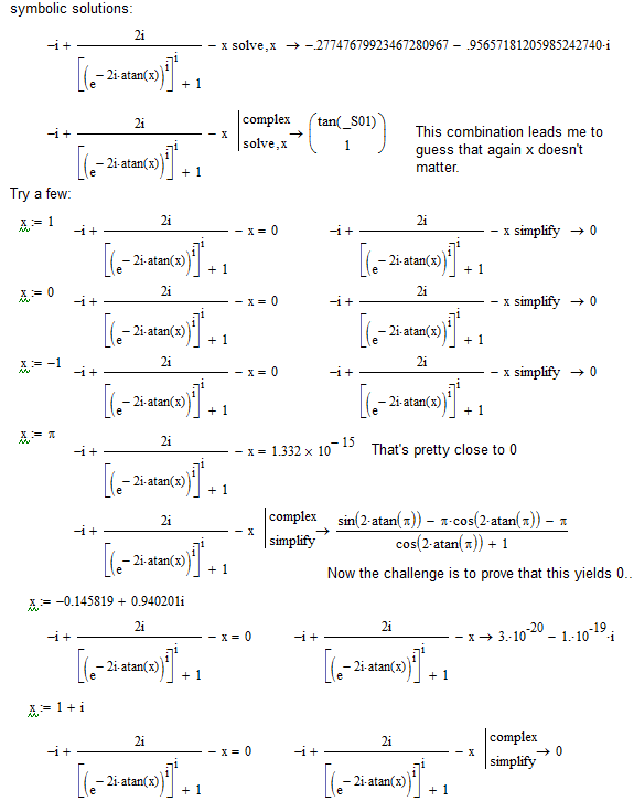

-1i + { 2i / [ [(e^(-2i*atan(x))^1i]^1i + 1 ] } = x . Find x ? . How many solutions ?

Its the identity again (at least from Mathcad's point of view).
Are you trying to tease us?

Werner was replying to Loi Le..
Anyway, there are much more solutions.
