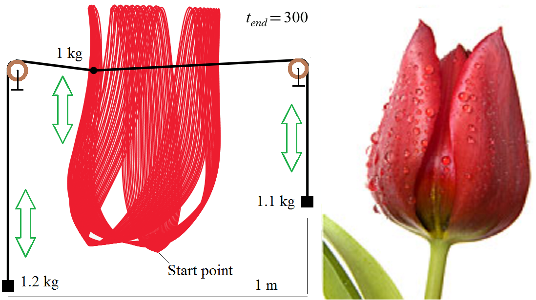

F.M. написал(а):
Beautiful, .... but the woman ... the one of the photo, is even more ...
Woman and Flowers!
You can change L, masses, start point and get new woman, flowers etc!
108 replies

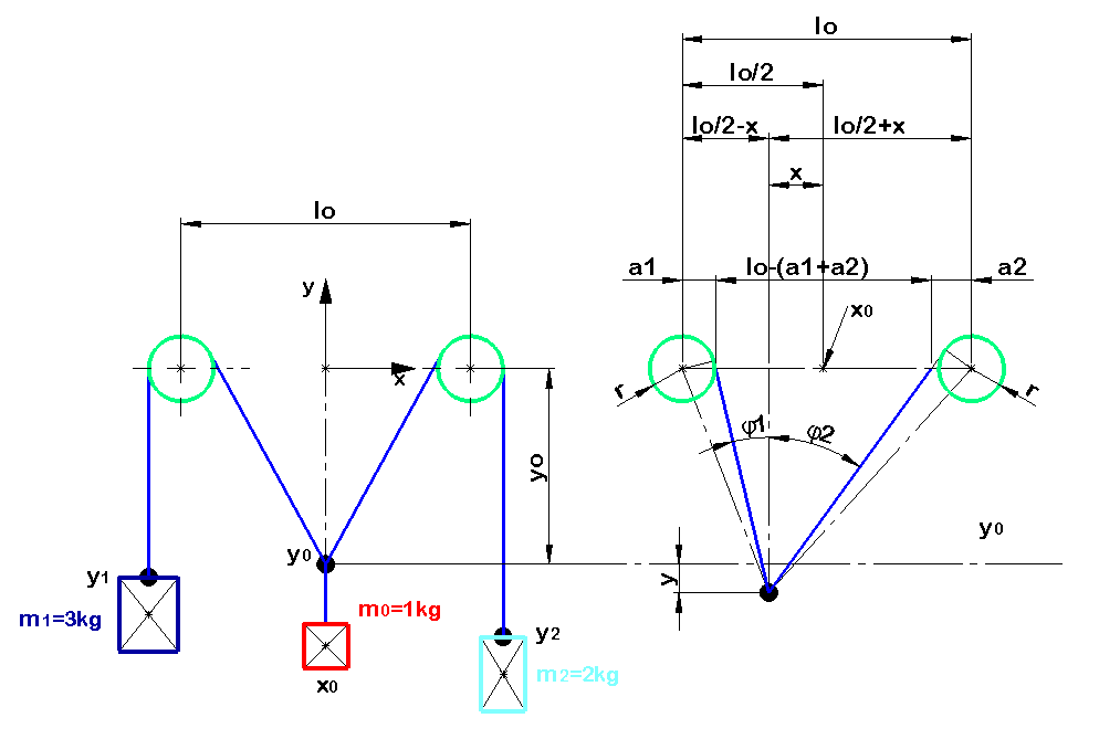

Wouldn't it be better, to study the geometrical relationships before starting calculation?
-MFra-
Hi Valery,
Can we describe the problem the following way?
The material system consists of five bodies: the masses M0, M1, M2 and the fixed disks' masses μ1 and μ2, of equal rays r. The wire is inextensible and, by chance, it does not creeping.
Determine the system motion and the tension in the wire.
Can we choose the location of the reference system's origin, at our discretion? For example so:
or is it fixed at L/2?
Thank you
F. M.
Hi F.M.
I guess it's fixed at L/2 and y0.
After releasing the weight m0 at this position, the system finds its equilibrium.
Putting the center of the first disk to the origin of the coordinate-system would be advantageous for solving with Lagrangesche Formalism.
The equations should be more simple than.
Viel Erfolg!
Volker

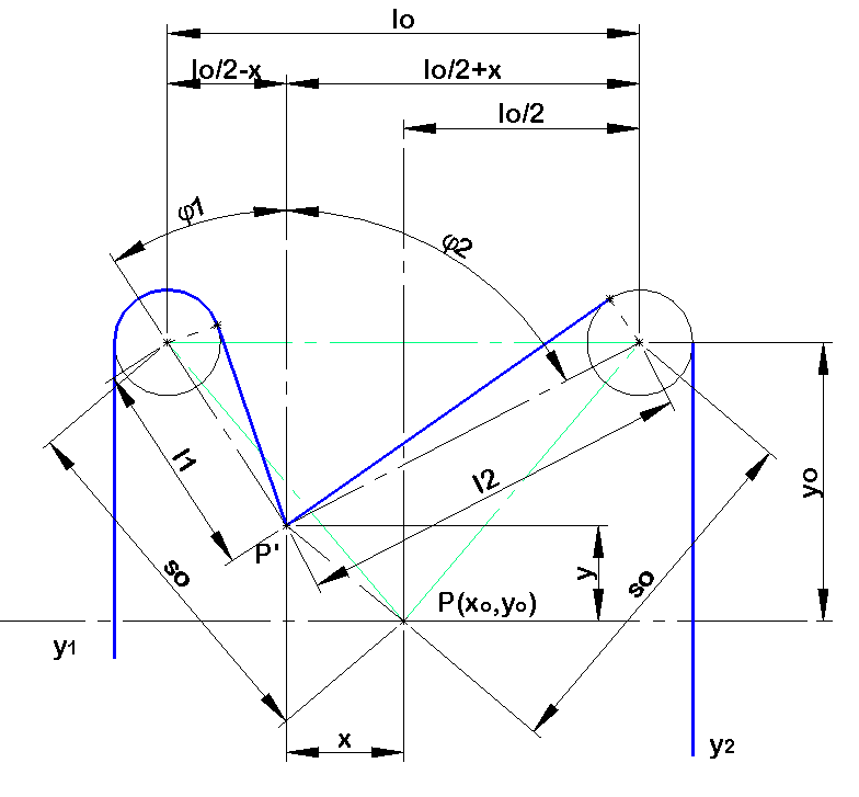

...Update:
and:

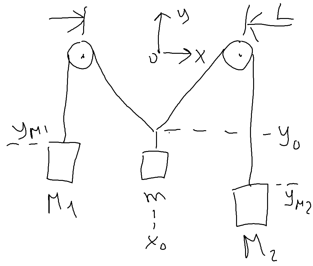

Situation of the acting Forces:
In attempting to solve a physical problem by physically setting up different forces for the physics of Newton's laws for an arrangement and to calculate these in the solution block using the Odesolve function, errors occur.
If I change various signs in my equations (although this contradicts the physical correctness!), I get a result.
From a scientific point of view, the application of the solution block on this point makes no sense from my point of view.
Valery, I would appreciate it very much if you mention that in your report.
Thank you.
Volker
