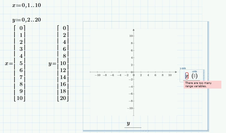

I am currently working on Mathcad Prime 2.0 for doing Engineering Calculations. While having to do the 2-D plot, I am facing a very fundemental Issue which seems wierd. I'm defining range for x as well as y. I am also extracting both the values and placing them. While I define the 2-D plot I am getting a strange error saying "There are too many range variables". I've attached a snapshot for your reference. Kindly help on this issue ASAP.

You have no correlation between x and y.
If they were both vectors of the same length, the plot would work; but range variables aren't vectors.

Sounds Legit!
