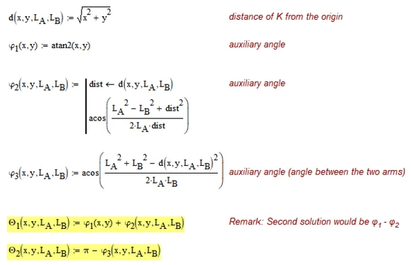

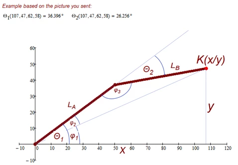

If you limit Theta2, too (positive in the range from 0 to 180°) you have a unique, single solution.
One way to calculate the angles Theta1 and Theta2 based on the coordinates x,y of the endpoint is shown in the picture below:

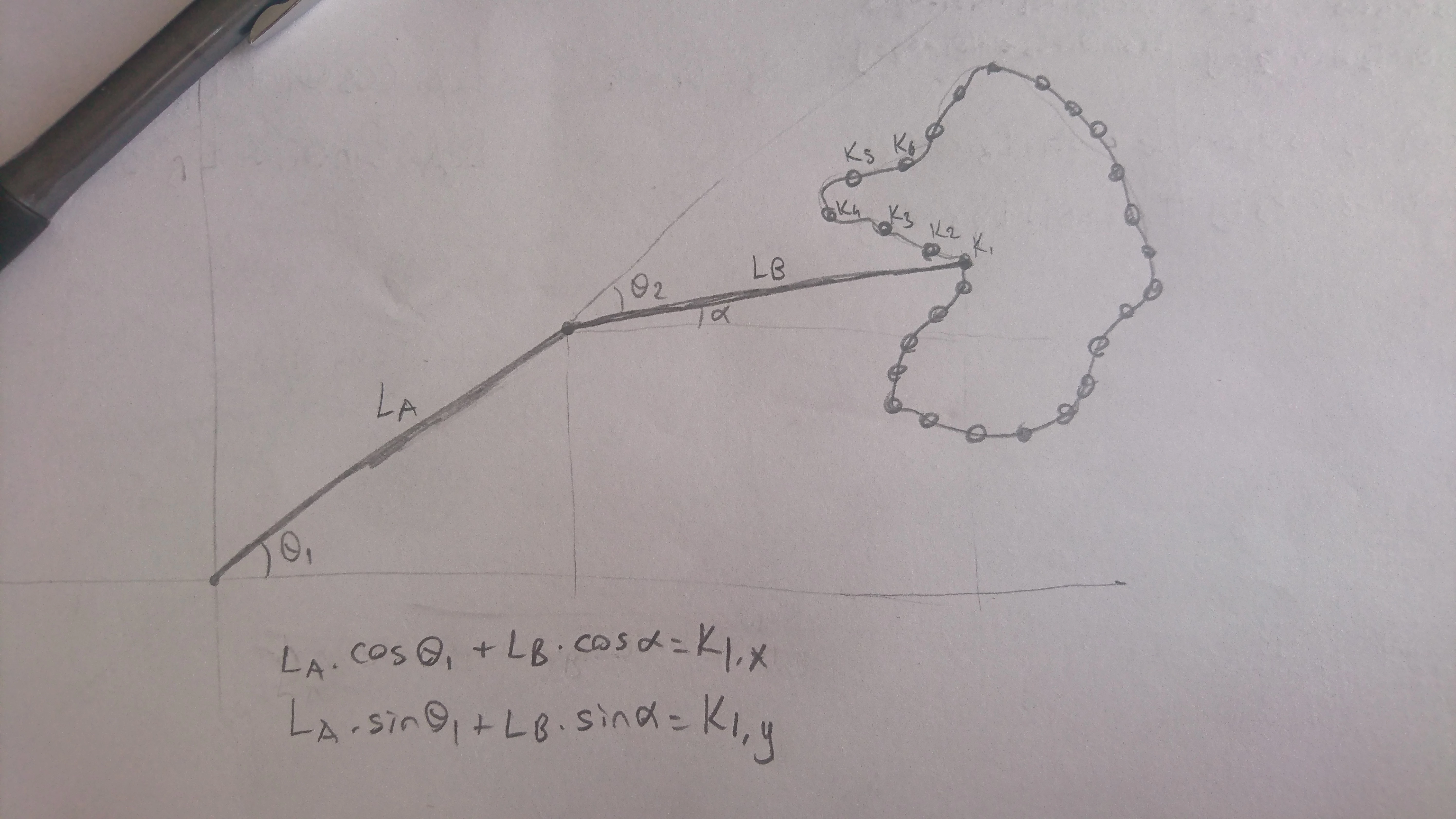

tasdemirg1-VisitorAuthor
March 9, 2019
Thank you for your intention @ValeryOchkov
 I'll show with sketch in add.
There is K.i matrix. It consists nodes that arm going to reach. Arms are should be rectangular boxes. I wrote the translational and rotational matrix. Arms are working perfrectly fine. But it needs target node in order to calculate teta1 and alpha angles.
For example K.1 is (x,y)=(450,600)
It will calculate these angles then will go to K.2=(460,590), later on K.3=(465,582) and so on.
I will later make K.i matrix with bezier if I can finish this earlier. It has manual nodes added by me now.
I hope I could explained myself clearly. Thank you!

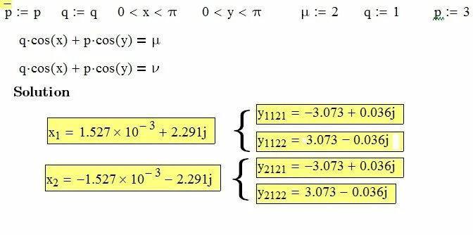

May be so

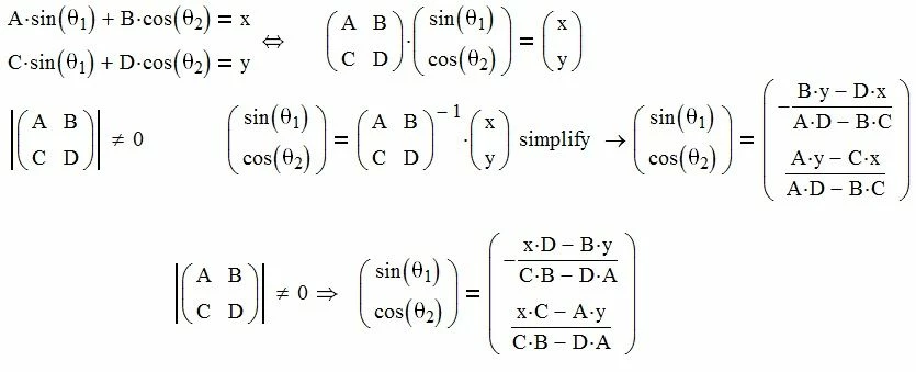

The analytical solution gives me these results:

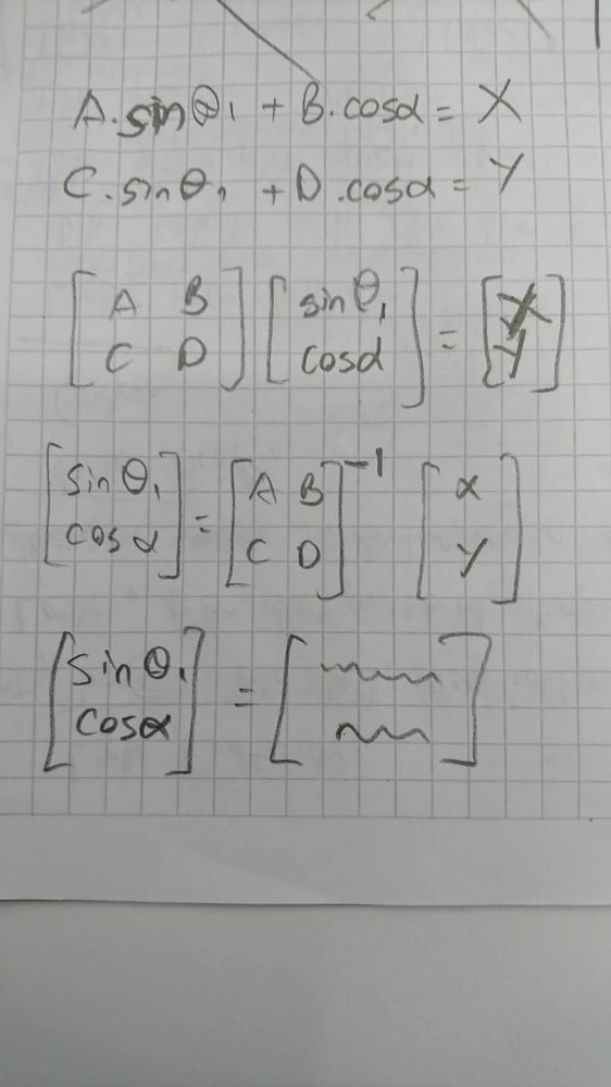

March 9, 2019
When a function with sin and cos, it's easier to make matrix solution. However in my function, there are only cos or sin one function :(. I have to make a general matrix solution. I am sorry I couldn't understand by your point. What do you suggest me to do exactly. I need this kind of solution below:
