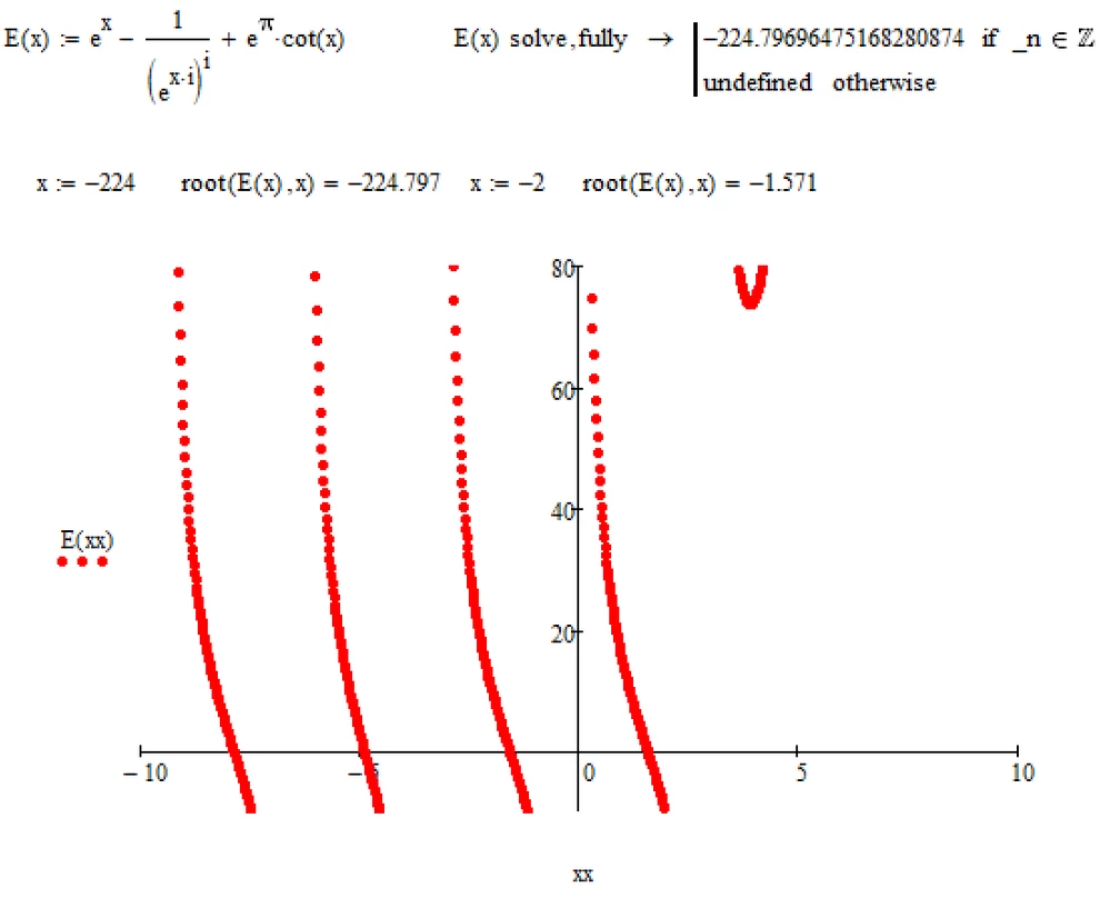

-224.79696475168280874 and meaning ?
Hello Everyone.
From :
Thanks in advance.
Regards.

Mathcad is saying that your equation has a root (E(x) =0) at the number given (-221.____)

As demonstrated in the other thread (https://community.ptc.com/t5/PTC-Mathcad/solve-x-fully/td-p/578709) the two first terms ( e^x and -(1/e^(i*x))^i ) cancel out. You're left with (e^pi)*cot(x).
That should give repeated roots at pi/2 +n*pi.
October 28, 2018
@LucMeekes
No! Not if we see it as a complex calculation which we have to do as the imaginary unit "i" is involved.
23-Emerald V
October 28, 2018
I see. Thanks for reminding me that (a^b)^c=a^(b*c) only when b and c are real numbers. When either one is complex, things become more complex.
October 28, 2018

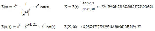

Keep in mind that with E(x) you are not just defining one single curve but rather a family E(x,k) of an infinite number of curves. One of them (k=36) has one root at the given -224,79..
For more details see here: https://community.ptc.com/t5/PTC-Mathcad/solve-x-fully/m-p/578762/highlight/true#M183096
Whenever the symbolics switches to float mode its not capable to give you all roots any more. Similar to numerical solve methods but with the difference that the numerics will respect any guess values or ranges ("root" function) while the symbolics usually will ignore any assume statement in this case.
