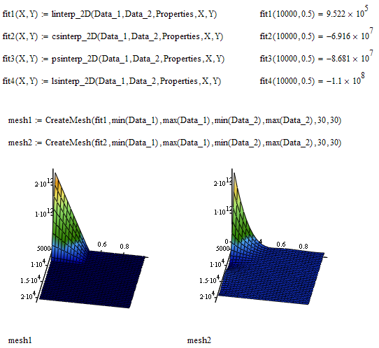

Splines tend to oscillate, so its no surprise you also get negative values in your interpolation - especially given the wide range of your "Properties" values.
Its interesting to see that Freds interesting tricky way works and gives positive values.
I would stick with a simple 2D linear interpolation.
As Mathcads 2D interpolations restricts me to a square data matrix I had written a few 2D (and 3D) interpolation routines which do not have that restriction. See attached file
Here is the 3D-plot using Freds function
Maybe his function is more appropriate for your purpose - you'll have to decide.

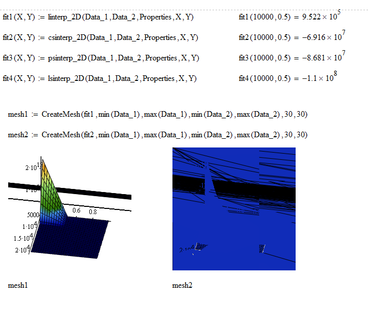

Dear Werner, could it be that you have attached an older version of your file? When I open it with MC 15.045 I see this:
As you can see there are some strange issues in both plots.
No, its saved with MC15 M045.
But 3D-plots are lknown to be problematic depending on OS, video driver, setting of color depth and graphics acceleration.
Not sure why you see those distorted plots.
