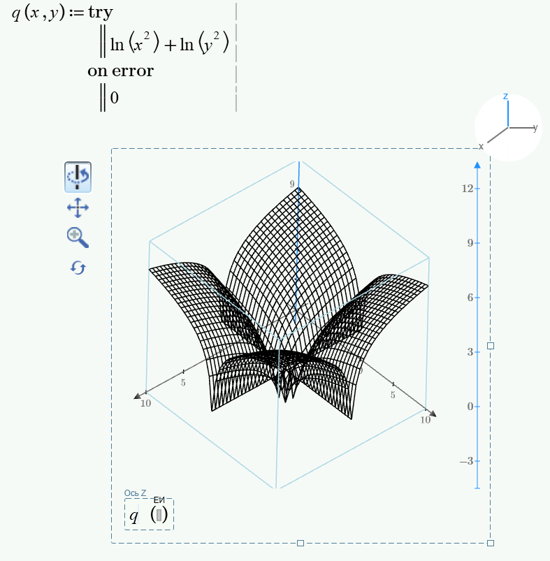

In Mathcad 15 you could use onerror similiar to what Valery had shown, but I would not return 0 in case of an error but rather a value like -10^(-8).
In Prime I would return NaN in case of error (unfortunately Mathcad 15 does not accept NaN in 3D plots).

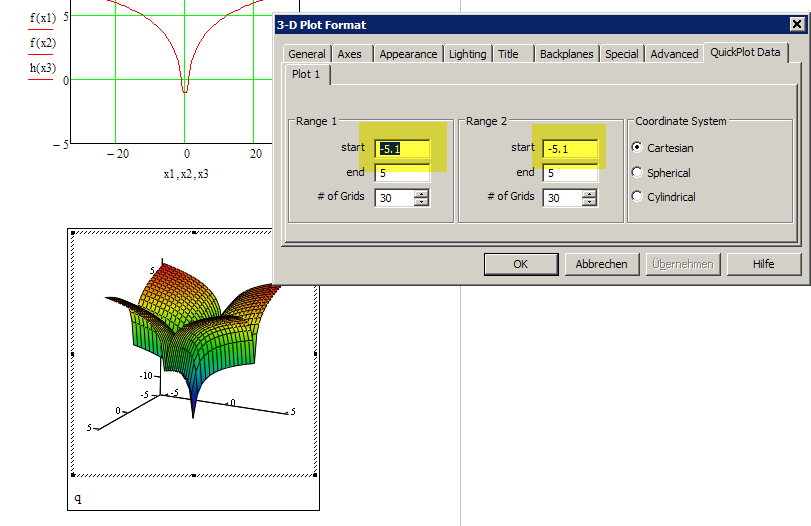

You may also consider to simply chose a mesh which avoids zero values for x or y:

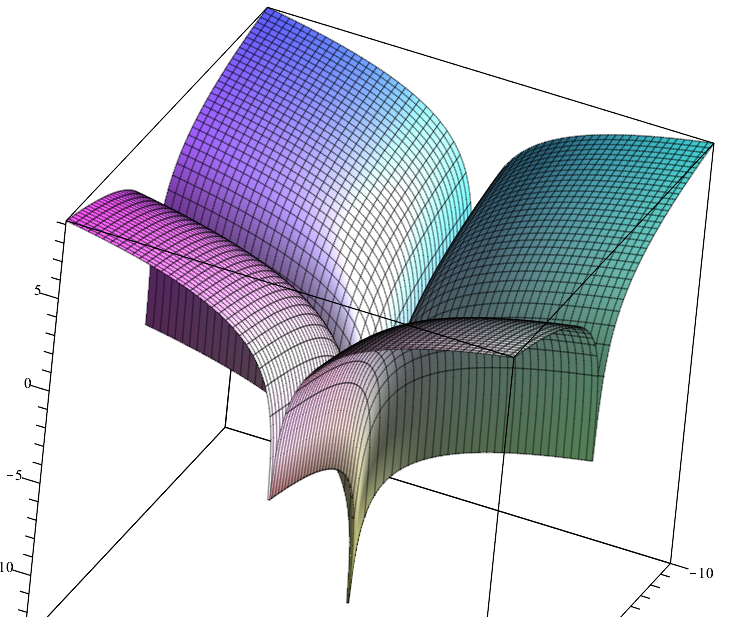

Fred had rotated your piciewise function around the z-axis.

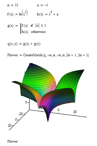

I did something similar to what you tried with q(x,y)

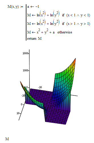

Oh,  just now noticed that you tried to define a function M further down.
You defined local functions M instead of assigning the result a local variable M (you may chose any other name here).

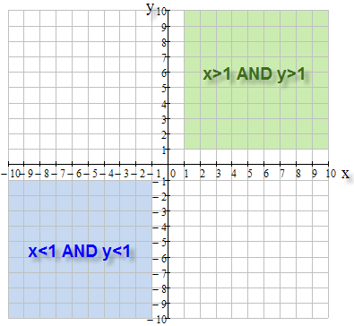

Furthermore your condition was faulty. You cannot write "(x AND y)>1" but have to write "x>1 AND y>1". At least I guess that this is what you had in mind.
But your logic seems to be faulty - I guess you had something different in mind that what you get here.
Just image where in the xy-plane the points are, where both x and y are either >1 or both are <1!
Werner
