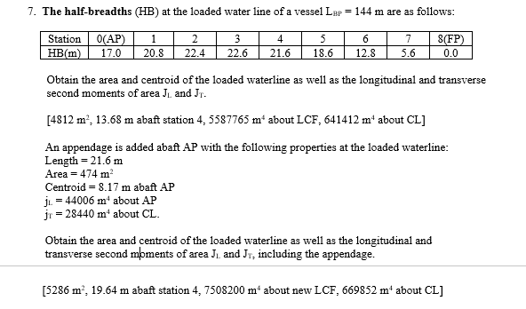

This is the overall task:

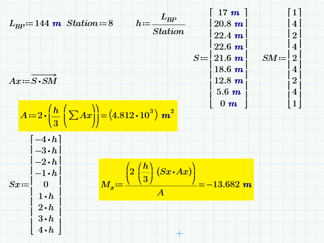

So far I have calculated the area, centroid and second moments for the waterplane as follows:
and

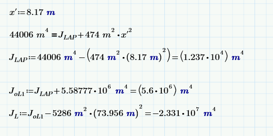

What I then struggle with is combining the second moments of the two shapes. I am of the belief that I can get the overall second moment of the entire waterplane by adding the two individual second moments about centroids i.e. JoL = JL (for the ship) + JL (for the appendage)
I have JL for the ship and I believe to get JL for the appendage I need to convert the second moment about the aft perpendicular to the centroid which I thought could be done as follows:
But I am obviously not getting the answer right for JL. I have also not even got to thinking how the overall JT value is obtainable?

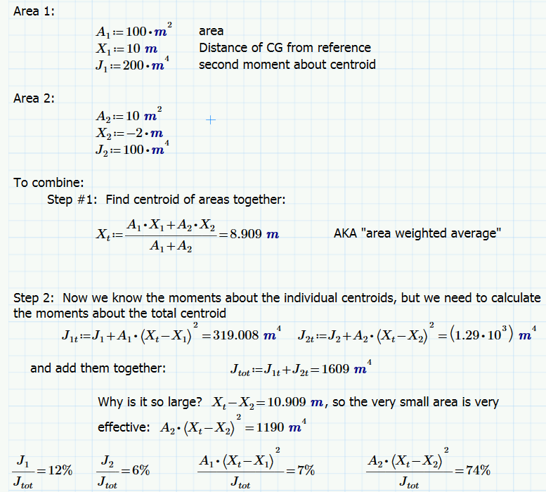

Best answer by Fred_Kohlhepp
An example

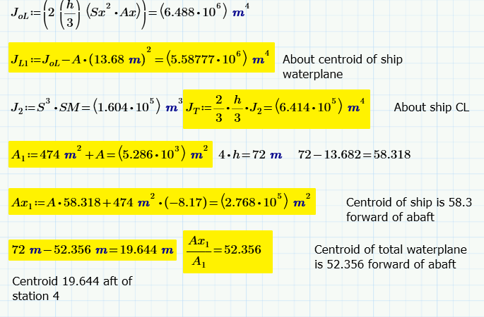

Your calculation of areas and moments is some form of finite difference scheme.
If I fit a polynomial to your data points I can apply the integration scheme.  (attached.)
Note that I believe there's a typo in the answer given for total longitudinal moment.

Hi Fred,
I was hoping you would pick this up.
The problem is to be done using simpson's first rule which I have done and that is the method it needs to be competed in I believe.

23-Emerald I
March 31, 2017
Let's try this again
