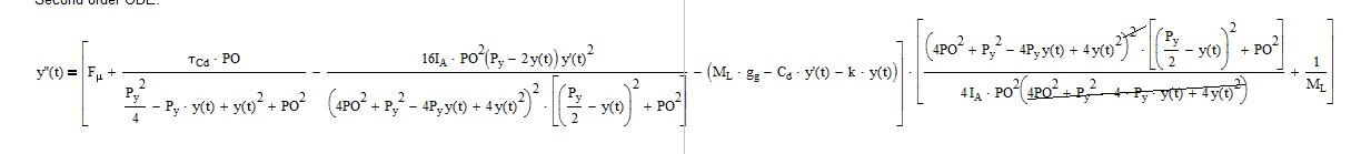

You have missed a simplification:
standish1-VisitorAuthor
Hi F.M.,
Well spotted, thanks!

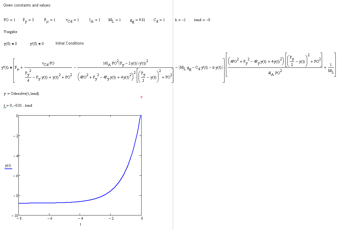

I got a solution with Odesolve - with negative t values and this is very strange.
Can it be because of the equation?
What is the basically differential equation?
I need a physical description e.g a damped system with a spring etc.
Maybe i can give you the complete lagrangeschian formula of your system.
See Attachement please.
best regards, Volker
