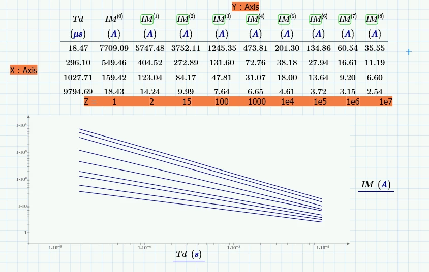

3D curve from one matrice or table and vector the Z
I'm trying to generate a 3D curve from a table or matrix of (X, Y) values along with a vector Z, which contains one value for each (X, Y) pair with Mathcad 11.0.
I tried using createmesh, but without success.
Do you have any suggestions on how to achieve this?

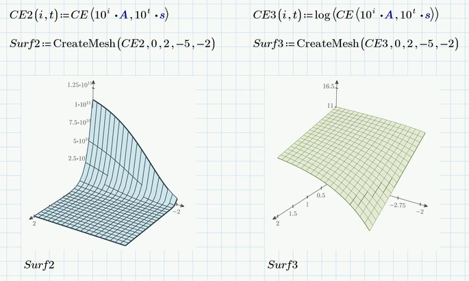

Prime's 3D plot only allows units for the z-axis, x- and y-axis values must be dimensionless.
Here are two attempts to plot your function CE. Both use log scale for the x- and y-axis. As Luc already wrote Prime does not support log scales in 3D plots, so the functions have to take care of this. The right plot also uses log scale for the z-axis as well.
In both cases current i is running from 1 A to 100 A (i = 0..2) and time from 10 µs to 10 000 µs (t=-5..-2)

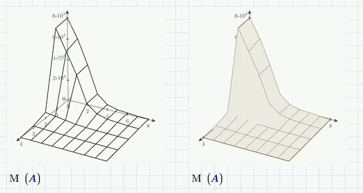

I don't think that Prime can plot reliably and meaningful a single 2D matrix (its also missing the corresponding x- and y-values).
Here is what I get when I plot the matrix M at the end of your sheet. Values at x- and y-axis are simply the index numbers.

The Matrix is NOT available at the end of the worksheet, because you did not supply the Excel sheet with the component data.
To use CreateMesh, you need a function describing the surface. You don't have a function.
But you do have a matrix from the table data, it's called IM. And you should be able to plot that in a 3D plot.

I also have a function CE(IM, T), but I’m not able to plot this graph in 3D, maybe due to units ?
