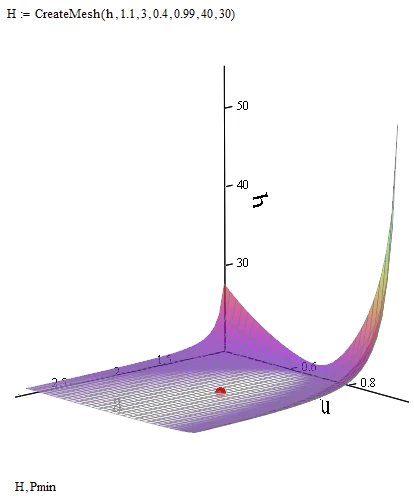

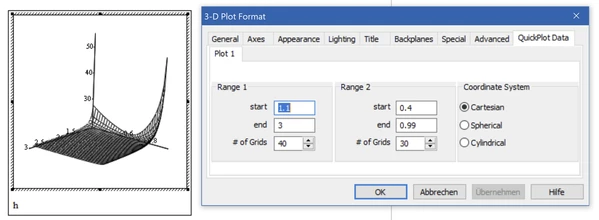

You could simply plot h, but you will have to manually edit the ranges for the input variables so that the calculation does not fail for any grid point.
Its more convenient to use the "CreateMesh" function and plot the created nested arrays

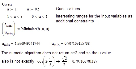

or you could use "minimize" to find the minimum
The values found do not exactly match the solution you name.

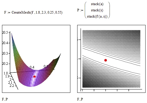

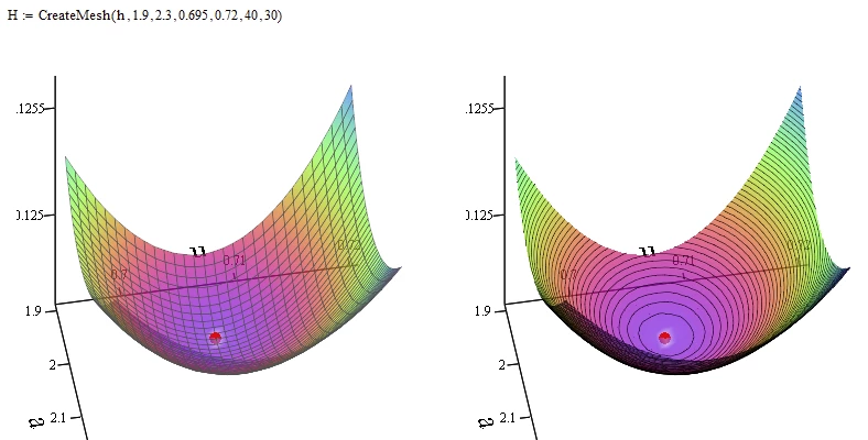

BTW, using CreateMesh its not to difficult to "zoom in" for better clarity.
You may also define the function as its given originally.
I don't think that Mathcad is capable enough to provide an exact symbolical solution, but we can get a numerical one either by using "minimize"

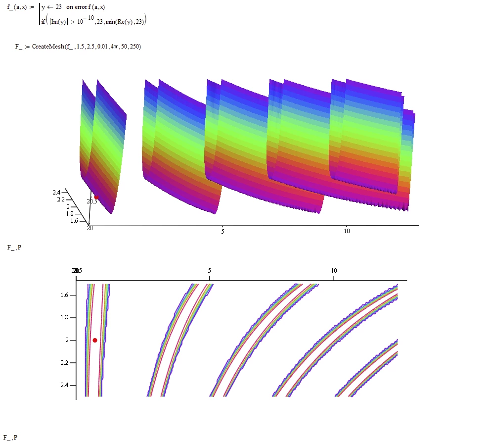

You may also demonstrate the periodicity, but you will have to copy with non-real z-values. Unfortunately unlike the 2D plot, the 3D plot does not accept (and ignore) NaN's, so I set non-real values to 23 and limit the z-axis in the plot menu to 22. Just to be on the safe side I also do the same for values which may make the function fail (zeros of sin or cos which make the log fail)
