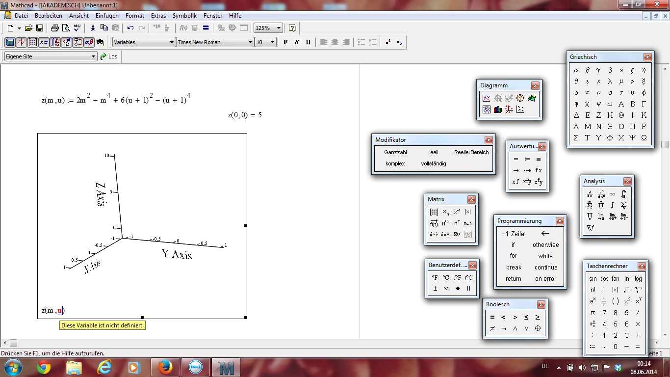

I am trying to visualize a function with 2 independent variables like z(x,y) := .... but it does not work.
Everytime I generate a "Surface Diagram" / "Surface Plot" and say which function I want to get visualized, Mathcad says "The variable is not defined." to one of the two independents.
I look forward for some useful hints!
Greets
phil

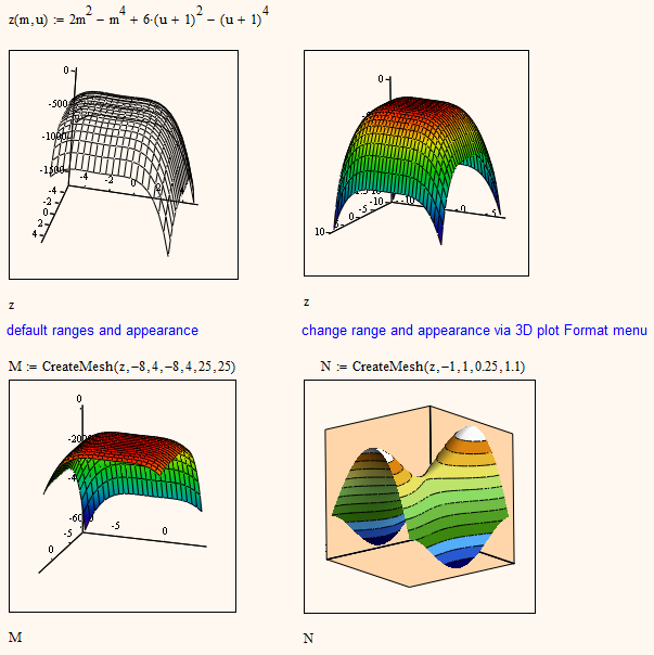

* 2. place name of function in the placeholder in the lower left corner
Thats the point! Just the name - no parentheses, no arguments!
What about the quicksheet I mentioned?

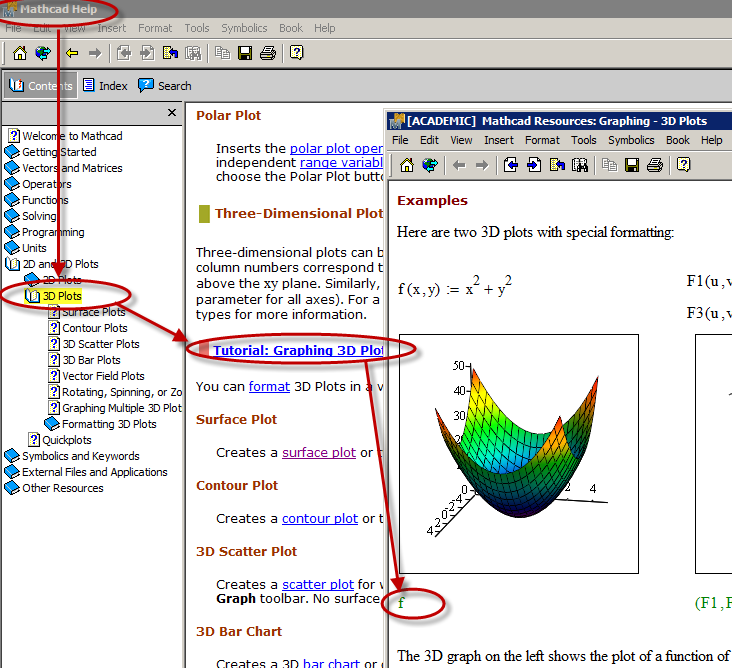

The help section about surface plots provides a link to the explanation of the CreateMesh() function just a few lines below the text you cited and again, if you follow that link and the information there is not clear enough, you are offered a link to the appropriate Quicksheet. This sheet deals mainly with parametric function but the syntax to use should be clear nonetheless with the information provided there.

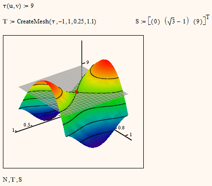

You may also add the saddle and its tangential plane

Simply look it up in the help - what syntax did you lookup there for 3D plots?
Lookup surface plots and if the text isn't clear enough, follow the link to the quicksheets and look at the 3D plots tutorial. The very first example covers the syntax to use in your case.
Another way which gives you better control over the ranges of the two independent variables other than changing the quickplot data is the use of CreateMesh(), though.

I looked up the help to create a 3D plot.
But every step described in the mathcad help for "3D Flächendiagramme" / "3D Plots" was done by myself:
* 0. Generate a function like mine (z(x,y) := 2x^2 - x^4 + 6(y+1)^2 - (y+1)^4)
* 1. [Strg]2 for a space for 3D Plots
* 3. click beside
-> Mathcad should generate the 3D plot now, but it complains about one of the two independents.
(When I use z(x,y) it complains about x and if I use z(m,y) it complains about y and so on...)
Have you seen my attached file?
There you can see that I accted exactly like described.
And when i click the 3D plot tutorial, there is nothing else new to see. :S
Can you explain what CreateMesh() should do, or how to use it?
