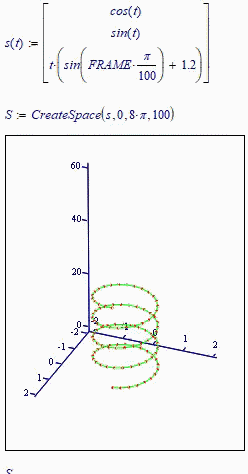

The first animated plot that I want to create is of a spring moving. The wxMaxima code for this is shown below.
This creates a 3D plot of a spring that is stretching and expanding.

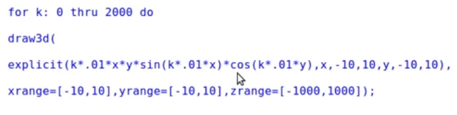

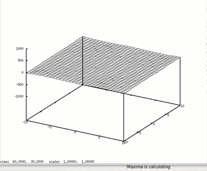

The second animated plot that I want to create is a vibrating sheet. The wxMaxima code for this is shown below.
The animated gif is shown below.

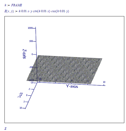

Here's your second animation with k running from 0 to 200, repeating:
The above shows the entire contents of the Mathcad sheet. When selecting Animation from the menu, I chose FRAME to run from 0 to 200, at 10 frames per second.
The resulting animation was saved as an .avi file (the only option) , which was then converted to an animated gif using external software.

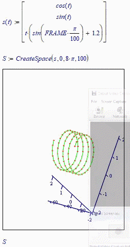

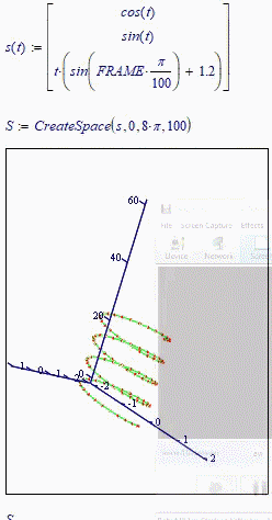

There's another type of animation possible with (real) Mathcad: you can rotate a 3D plot:
LM_20210208_SpringRotate.gif   LM_20210208_SpringRotate2.gif   LM_20210208_SpringRotate3.gif
To show it here, I had to capture a screen-video, and convert that to an animated gif. Both with other software.
Enjoy!
