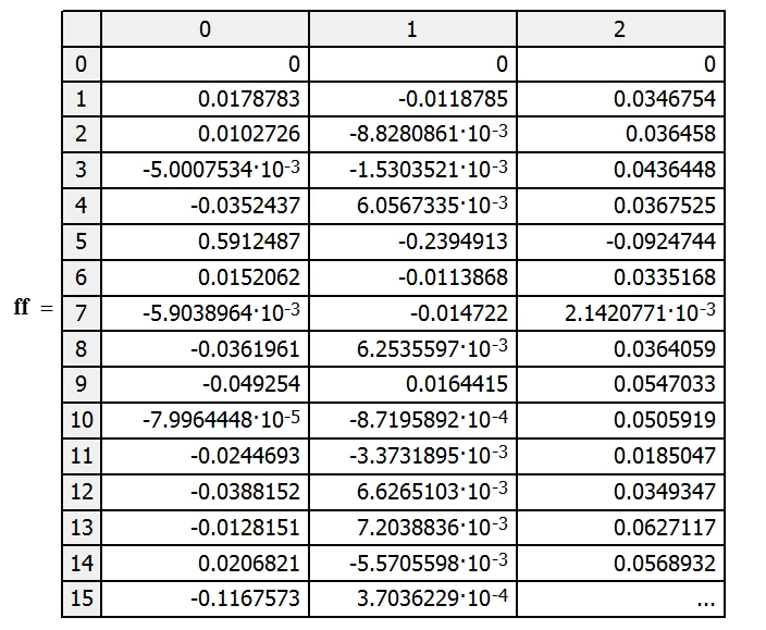

Hello All,
My program returns calculated parameters in a table like the attached picture. How can I address Mathcad to 3D-plot the the first column vs the other columns. How can I recall the data from the dolumns to use them for the next programing stage?
Thank you.
Payman

  1. You have created 3 plots instead of 1. You have to put the three vectors in parentheses - use ' for this
  2. You have to chose plottype "scatter plot". You have not enough information for a surface plot.

Please post your worksheet, not just a pic.
The answer for both questions is about the same: Use the matrix column selector (Ctrl-6).

thank you. The program is attached. I want to plot the first column on z-axis and the other columns as x-y.
Your comment was helpful. But the plot is not stable. How can I make it to appear constantly? or make a copy of the plot ?
Thank you again
