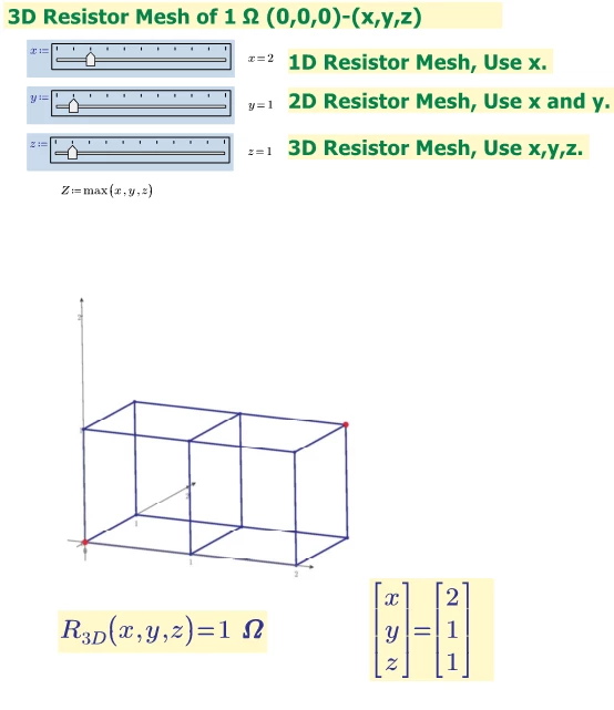

Now I have a practice issue to research - how the k1 value depends on the d1 and d2 independent values.
I obtained the flat surface only using the slider ( for a particular value of d1 and d2, respectively). I understand that Prime did this calculus for only one pair of d1 and d1 values. Instead, it is useful to research the whole range of default independent values (d1 and, in my particular case), as they are easily obtained for the sample function (Slider usage sample file).
At this moment, two questions  are up in my mind:
1) Why can I not see the trend through the range of these variables ( i.e., d1 and d2  changes from 1 to 100 cm) and the k1 value, too? (see Thermal performance calculation ... file).
2) Why can I not deliberately set the start of the axes for d1 and d2 values from zero point ( as it is possible to do with the X-Y plot type)? (as is possible for the X-Y plot, see the slider usage sample file.)
I want to use Prime's powerful engine possibilities, but they do not seem very suitable for my particular purpose (perhaps).
Any advice would be appeciated.
ttokoro
Jan 11, 2025 11:06 AM UTC
t.t.
Ivan_Pat13-AquamarineAuthor
Jan 12, 2025 4:59 PM UTC
@ttokoro Thanks a lot for your assistance with a clear example
