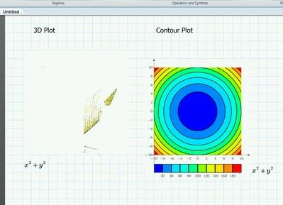

Hi Folks,
I'm trying to do 3D plots in Prime 7 to show my students.  The contour plots appear correct on the screen, but the 3D plots (surface plots) don't.  They look OK when I save to PDF, though.  Any idea what I'm doing wrong?  PDF and screen shot are attached.
Also, only the quick plot function seems to do 3D plots.  Am I missing something?  3D plotting in V15 worked at least as well as this.
Mark

Updating drivers would have been my first (and only - OK reinstallation of Prime might be a second one) idea to try to fix that kind of problem, but of course its just a shot in the dark.
I found nothing which would address this problem in the Knowledge Base but it may be worth a try to open a case at PTC support.

Have you already tried updating the drivers for your graphics device?
??? Do you want to say that a structure created by a function like "CreateMesh" does not work OK?
You may want to attach a demo sheet which shows the error and does not work on your side.

This is a new machine and I assumed the drivers were up to date.  I'll talk with IT tomorrow about an update.  it's unlikely that I have permission to update drivers myself.

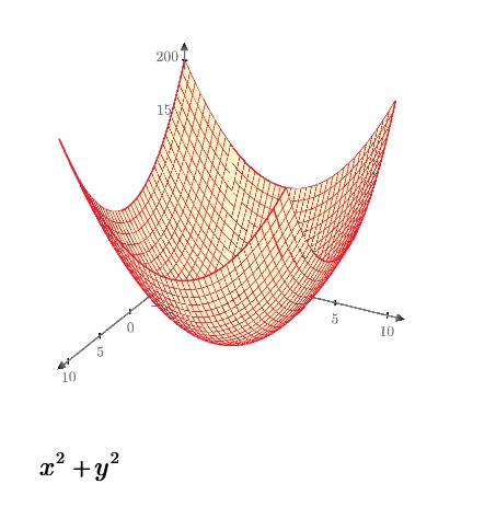

Prime 7 shows this 3D plot for x^2+y^2.

Thanks for checking.  3D plots work on a different computer, so I think WernerE might be right - screen driver might need an update.
