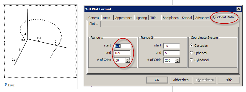

In MathCAD 14, I am having trouble making a 3D scatter plot when the matrix-function contains an element that is a natural log function. The same matrix-function plots OK If I substitute and different function for the natural log function. I have included an example file; why does the p.2xyz function plot OK and p.1xyz not plot at all?

Unlike a 2D-plot a 3D plot will not respect and use your range t. So you used the 3D quickplot and it defaults to a range from -5 to 5. Give it a try, change your t-range and watch your second plot - nothing will happen.
The negative values in the range [-5; 5] throw a complex result, 0 makes the log function fail. Unlike a 2D plot a 3D plot fails if just one result is complex or NaN or the like.
To make your plot work you have to edit the quickplot range accordingly:
It may be more convenient to use the CreateSpace() function at the price of having to get rid of the units (which you should do in a 3D-plot anyway):

Thank you,
That did the trick.
