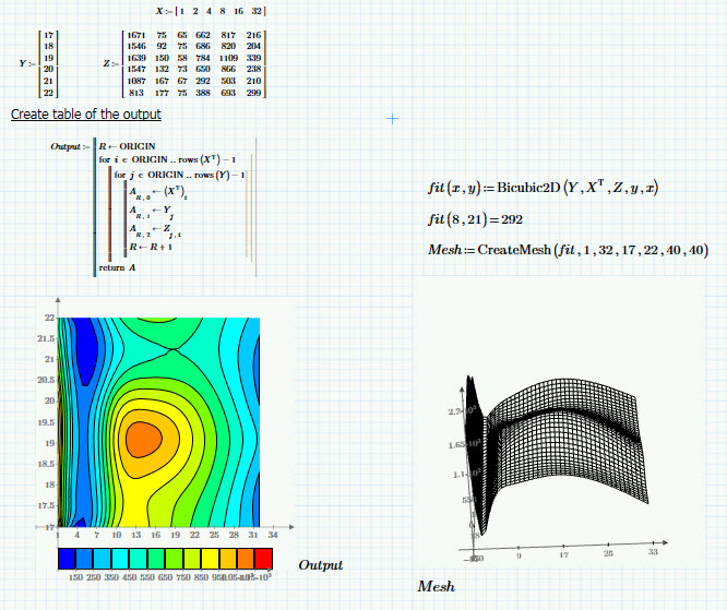

This is similar to Fred's.  Except some different plots.  3D plots as Fred made seem to be restricted to having the X and Y simply be counters (1,2,3, etc)  The contour plot isn't what you asked for, but may be the most visual.
May 5, 2017 9:02 PM UTC
Here's an extension with a mesh.  And I think I had my Z_i,j backwards.  mesh2.jpg

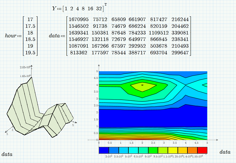

You could plot your data right away but have to take into account a lot of drawbacks.
You lose the information about x (time) and Y. Those values are substituted by the sequence 0,1,2,3,4,5.
Because of this you see a wrong (logarithmic) scale in y direction!

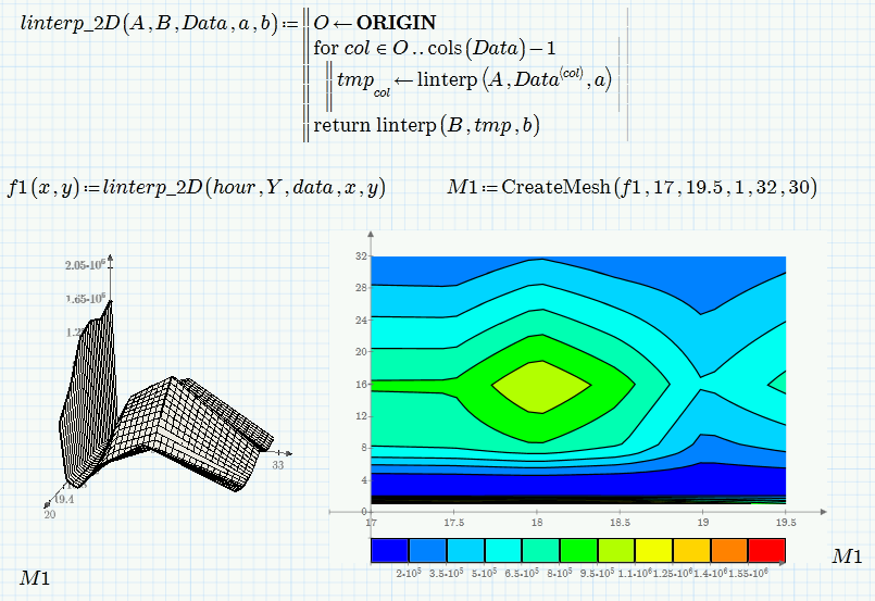

You may want to interpolate your data, turning the table into a function.
Simplest form is linear interpolation:

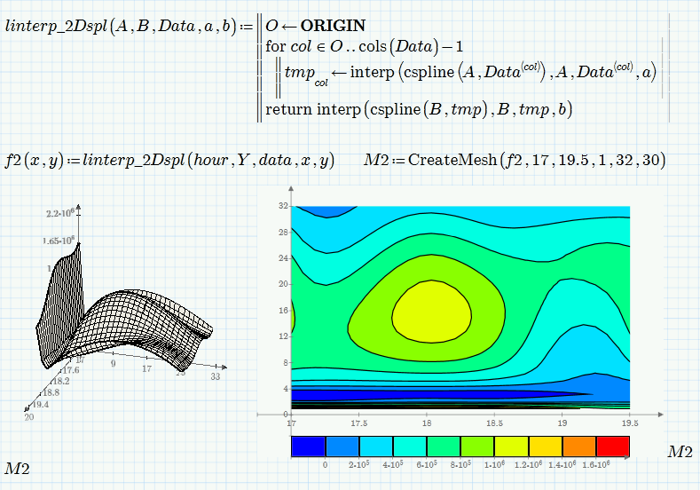

More sophistic is using splines for interpolation
Mathcad offer three different flavors for cubic splines - cspline, pspline, lspline.
As you can see, I used cspline. If you change that for lspline the result should be the very same as if using the built-in Bicubic2D.
There is a slight difference between the two as you can see in the attached sheet.

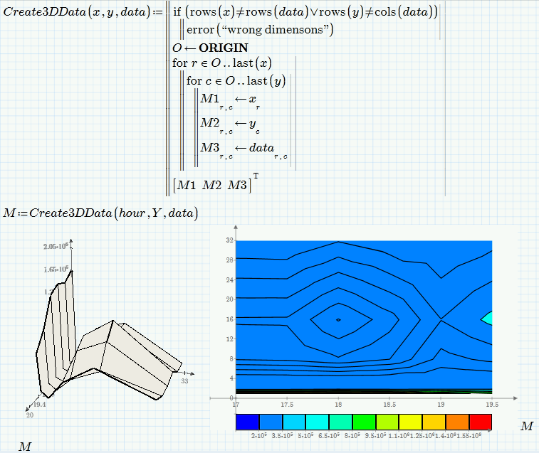

The data used by Mathcad to show a 3d surface is a little bit complicated and consists of three nested matrices. Here is a way to build that structure from row-, column-header and data table and then plot the pure data:
Attached file in format Prime 3.0.

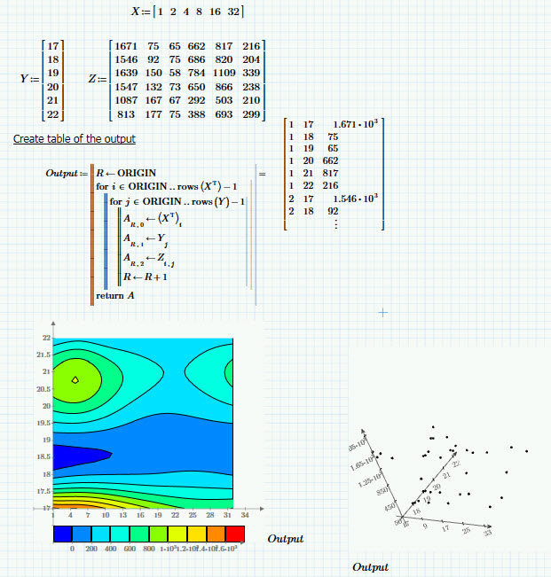

dferry in his first reply (apart from using differently scaled data) simply created a three column matrix - a long list of points.
That way he is losing completely the mesh information - which point is neighbor of which.
