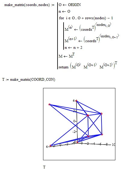

I need your help converting or perhaps coding a new routine to plot a 3D truss.
Yesterday after the help of some of you guys, I was able to get my hands on a solution for a similar problem here in this forum but solution was done in PRIME.
I tried the whole day yesterday to convert the code to the old V15 mathcad without success. So now I am asking y'all for help once again.
Thanks!
6 replies
There were some errors in your attempt to convert my routine to real Mathcad.
The data structure necessary to plot a number of points in Mathcads 3D plot is nested vector. A 3 x 1 vector whose elements are n x 1 vectors consisting of the x, y and z coordinates of the points to be plotted.
A possible conversion would be this
But unfortunately the result will not work in Mathcads 3D plot component because good old Mathcad has a severe limitation here. The 3D plot does not accepts NaN's and throws an error. I had uses NaN two separate line segments. Its one of the very few advantages of Prime that its 3D plot accepts NaN's the same way as Mathcads 2D plot does. Otherwise Primes plotting capabilities are mediocre up to useless.
You could omit those NaN's but now ALL points will be connected. The end of a line segment will be connected to the start of the next one. usually this will mean quite a lot of unwanted line segments being plotted.
At the time I can't think of a solution other than arranging the input data in such a way that the end of a segment is the start of the next one - maybe by drawing some segments multiple times. I guess this will not be possible in every case. Here is a routine which omits the NaN's and you can see the additional line segments if you compare with the Prime version.

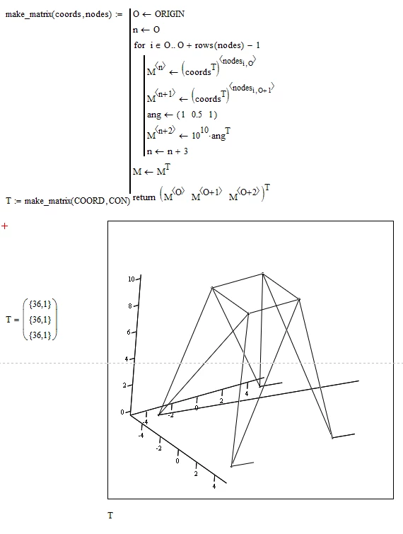

Though, here is my take on your solution.
Instead of using the NaN, I replace it with a coordinate located at "INFINITY". This forces the unwanted lines to go to infinity and back to start the next line. Further if we change the plotting limit to the magnitude of your real X,Y,Z values. The unwanted lines will be shown cut-off thus making the 3D truss plot to look a bit more like the real thing.

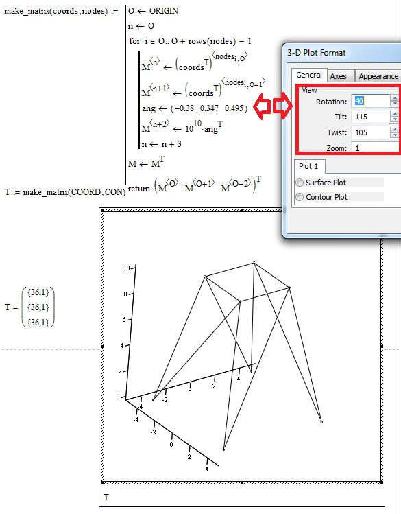

Additionally we can use the artifice of OPTICAL ILLUSION by rotating the plot so that the unwanted lines are along our line of sight, thus making the unwanted lines looks as a POINT.
This can be achieved ether by either change the ANGLE (variable "ang") to match the plot rotation, keeping the angle constant and rotating the plot or a combination of both.

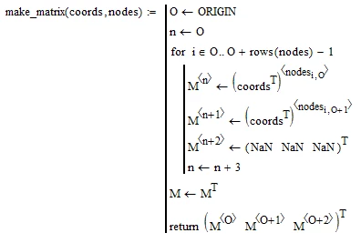

Use the NaN inbuilt varibale. I have managed to plot complex 3D wireframe in MathCAD perfectly successfully icluding meshes in a mannr one would expect with terminaiton of lines.

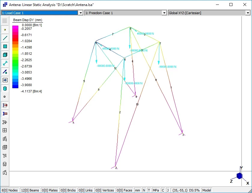

In engineering practice this is a waste of time as most engineering offices would use a ready made software package to do this like SAP, STAAD_Pro, SpaceGASS, Microstran, ANSYS, Strand (Strauss) 7,.. etc.  These provide not only the ability to plot the structure but also plot the results on the plot as force diagrams or deflection contours.  It is not a good idea to spend the client's money on re-inventing the wheel.
Whole analysis to design main members only takes one hour plus the rest of the day for the detailing of the joints and foundations.  There is usually a number of discrete load cases to examine, not just one.  The enclosed graphic took about 15 minutes to make.
The lesson to learn is when is it appropriate to use MathCad to solve a problem or do something in an engineering office.  It is a wonderful program.   For instance getting Mathcad to write input files to the engineering suites based on parameters to do a multi run parametric study is powerful.
