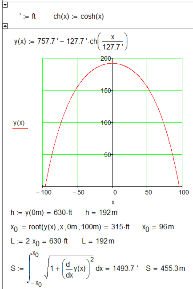

Now I am working on the chapter "Catenary" of the book "Mathematical Studies with Mathcad". See please one part here Catenary with load
I see that the value 630 feet  is very... magic value.
See please:
What magic or someone others do we have in 630 feet - 192 m?
On picture from the book:

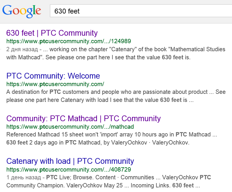

I have done the search in Internet one more. And what I got
