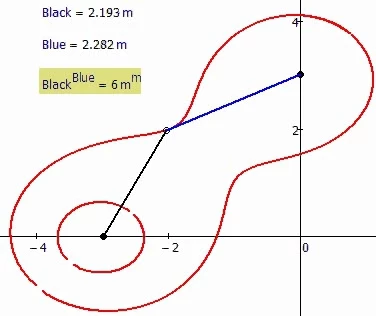

Hi Valery!
I know that you like to post animations an I know that one gains them most points (do you really care about them?) for creating animations.
But in my opinion one can also exaggerate it by posting the same or similar anis over and over again.
In this example you still have the wrong small oval! I already explained in the other thread that its an error an stems from a (non-existent) negative radius.
Regards
Werner

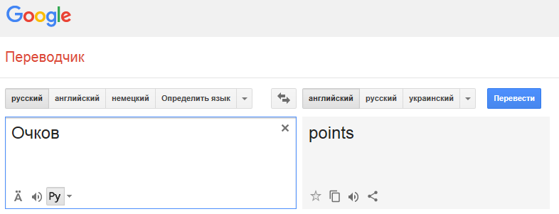

Thanks, Werner!
Do you know what is it my name Ochkov-Очков
July 6, 2016
That explains a lot 😉
Nevertheless you should correct the error (the small oval). Its easy to fix - simply let L run beginning from 1.00001 or similar.

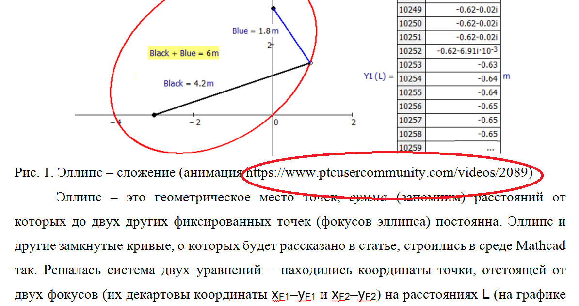

No!
It is for my new article - references from the article to animations!
Would you like to be a coauthor?
See please
