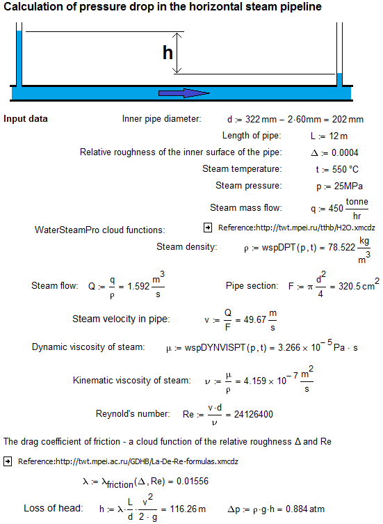

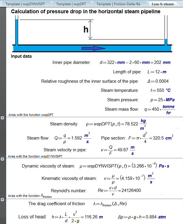

Attached is a steam flow pressure loss calculation.
I broke it down into three file. Please make sure your mathcad has internet access because
Thermodynamic Properties of steam flow is based on IAPWS-97 mathcad server . I really appreciate the authors effort
You probably has to rework the file reference in the "steam head loss PartIII " to point to the other file
the reference of viscousity calculation can be found in the mathcad file

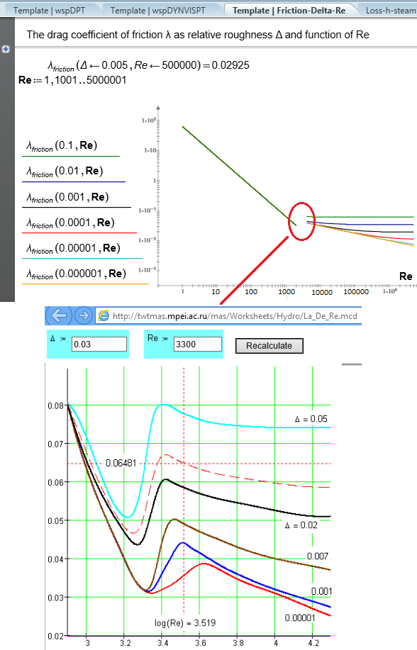

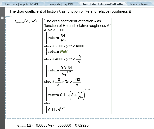

The fanning friction factor is simply a find(f) of the colebrook-white equation thanks to the power of mathcad, dont we all love that?.
I would like the community effort to check the validity of the calculation (I only check a few result and it seems to be matching table/graph value of steam pressure loss)
You can go to "steam head loss Part III" to change the pressure, temperature and piping data. Feedbacks are most welcomed!
