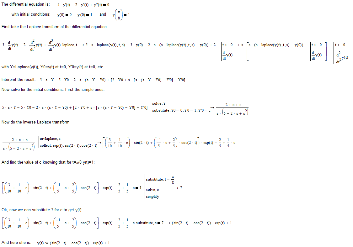

Here is the Mathcad 11 sheet that solves nth order differential equations with constant coefficients, referenced in the document thread with similar name here: A Classical Math Problem from a Classical Text (Differential Equation).
Note that this, as it is, is NOT usable for:
- Systems of differential equations,
- Differential equations where the coefficients of the derivatives are not constants (when they depend on t).
But in both cases, similar techniques can be used to solve specific systems.

Nice, but unfortunately it will not work in any version of Mathcad past version 11. The way you are using symbolic math in that first program was never officially supported, and was removed in version 12. Even if that could be fixed in some way, the Mupad symbolic engine can't handle the invlaplace expression

You can have Mathcad do most of the manipulations and some solving, even "abiding by the rules".
Then you still shouldn't need to use pencil and paper:
Prime should be able to do the same, using it's symbolics.
