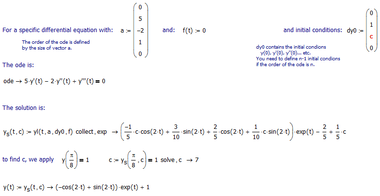

It's not extremely difficult to solve nth order ordinary differential equations with constant coefficients using Mathcad....
If you have Mathcad 11. Here goes:
Because (I assume) you don't have (access to) Mathcad 11, I add the pictures here.
And for those of you who do have access to Mathcad 11,I'll try to attach the sheet.
Which contains another axample:
