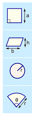

PS: the sketches could look like this (only the appropriate one will be shown):

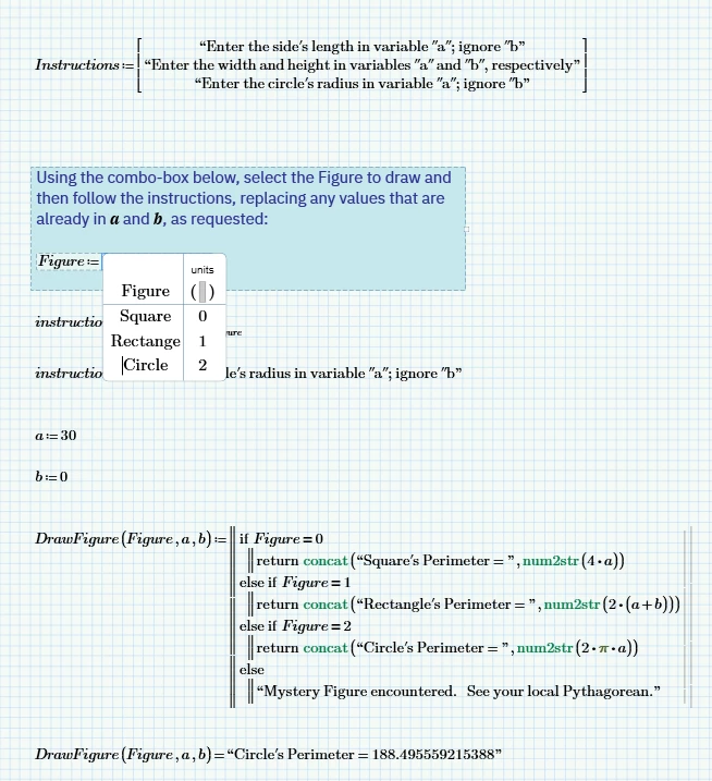

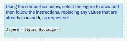

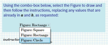

If you're using Mathcad 15, then the easiest way would be to use a programmable control.
However, if you're using Mathcad Prime 7 or Mathcad Prime 8 (full versions), then you could try a Combo-Box.
Making a selection ...
The left side of the Combo-box is hidden.  However, it doesn't hide the space that the left hand would use; consequently, the combo-box is offset to the right of where I wanted it.

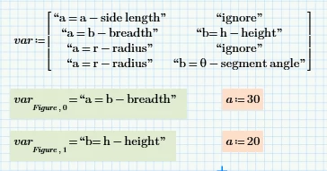

In Mathcad 15, you could try playing around with scriptable-control automation.   I vaguely recall writing and deleting Math Regions, but I can't remember what the process is.  Nor can I remember if you can actively collapse and expand Areas.   Hopefully, somebody with M15 can help out here.
On the other hand, you might also be able to circumvent the need for actual variable names if you merely need the names for the user.
In M15 and Prime, one way might be to create a matrix of equivalent names and display the appropriate ones besides a and b.   For example,
In M15, you might be able to do something similar using scripted TextBoxes, even disguising the variable names by hiding the left-hand side of the assignments.
Stuart
