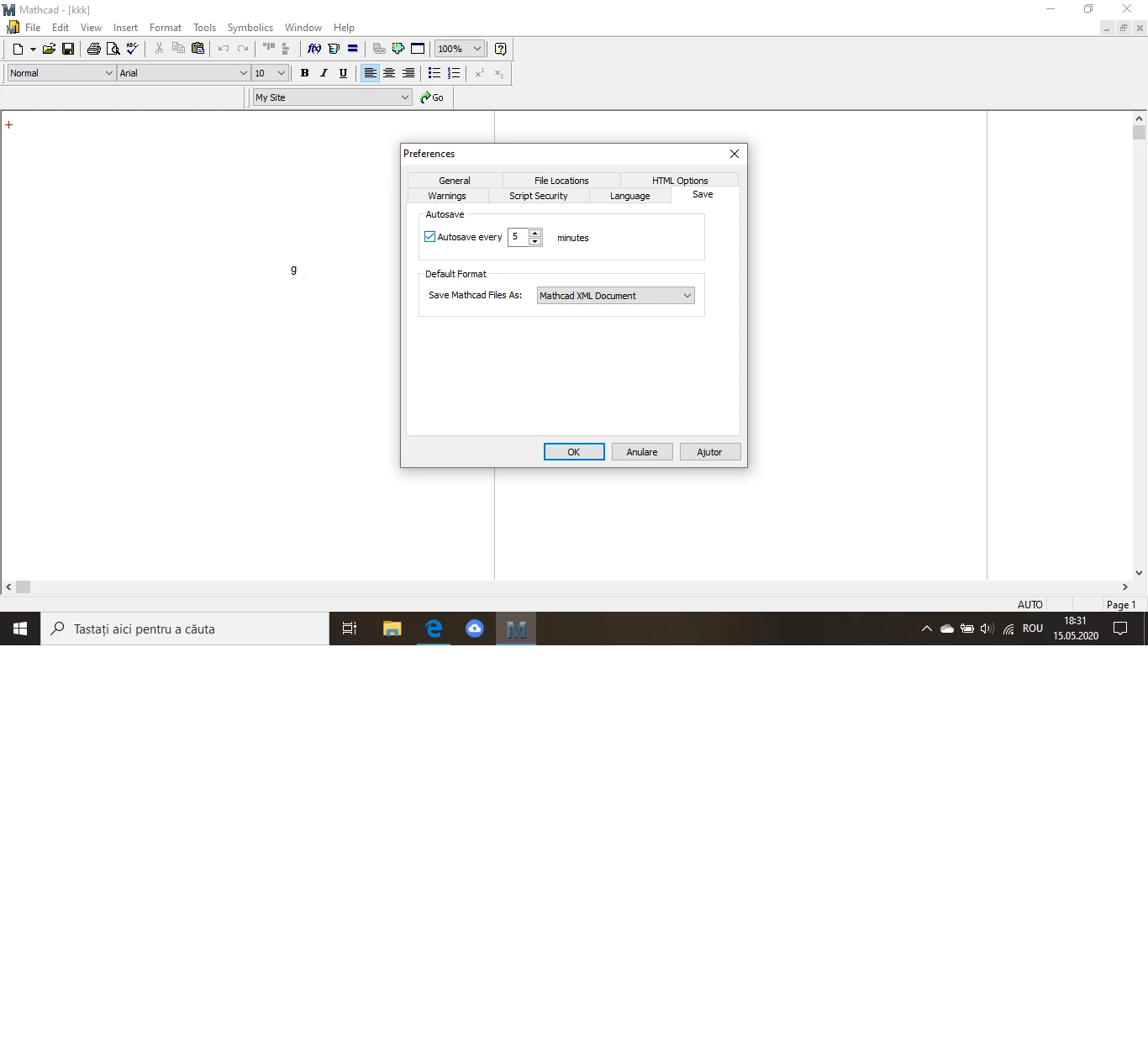

May 15, 2020
tools-preferences-save  - autosave (put v)
