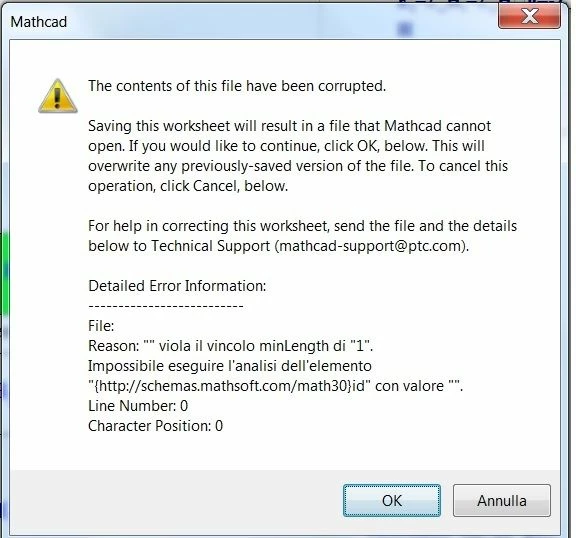

Hi All,
I have created, for a long time, a file that has grown more and more. Currently the size is 19MB.
For some time, when I save it, I find the attached deadly message ...... If I save the file it will reset 0MB ..... How to determine the cause?
Thank you.

It's PTC's problem, let them solve it, use the mail to support and maybe they will help you.
If you cannot send them the file, you'll have to dig into the file yourself. Note that a Prime sheet file is in fact an archive.
If you (use windows file explorere to) copy it to another file with extension .zip, you'll be able to open it and see what's inside.
One of the contained files is an xml file that holds the actual worksheet contents. That's where the digging starts...
All this is hopeless if you only have a .mcdx sheet file of 0 MB (or GB or whatever) because then your sheet is really lost. So I hope you have a backup..

I'm sorry, the file was made with Mahcad 15. And then, I should send all my work to who knows who?
September 26, 2018
That's what I said... If you cannot (or want not) send your file to support, you have to dig yourself.
A mathcad 15 file is (also) an XML file. Delete the second half of the file and see if that leaves you with a well-behaving first half. If it does, repeat with the last quarter..... etc. Until you pinpoint a small enough fraction that you can delete and later repair.

Hi All,
The cause of this horrible message, perhaps, is the presence in the main and in some reference files of definitions of indices and variables with the same names even if different definition intervals.
