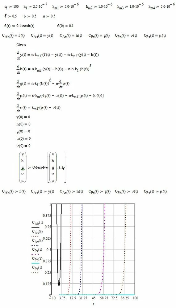

You should NOT use global assignments ( = ), but boolean equality to define the equations in your solve block. Type [CTRL =] to get those. They show as a bold equals sign ( = ).
November 16, 2019
Additional remarks:
1) You have to only use the function names without the argument parenthesis (use "C" and not "C(t)")
2) You have only 5 equations but 6 functions to solve for.
JPark611-VisitorAuthor
November 24, 2019
I attached new pic.
can you solve it please..
November 16, 2019
Thank you, can you attached file please?
