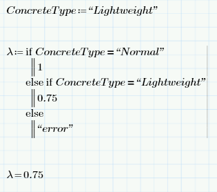

Do you have another variable in your sheet that clarifies if your concrete is normal or lightweight?
If so, you can do something like this:
If not, I'd just make a text comment:
