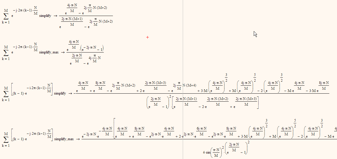

June 19, 2016
> This is more like a mathematical question, but not Mathcad question.
But you can use Mathcad to do the job 😉
Something like this:

Hi  Werner Exinger, thank you so much for your advise.   I have one question about the function of "simplify" here in your first pircture:
For the first simplify process, we know the result is the exact equivalent expression, not a "simplified" one.
My questions are :
(1) is the result in the second raw also the exact expression, instead of a "simplified" one?
(2) from the 2nd picture you posted, it seems like the answer of the question 1 is NO. Then would you tell me what kind of simplification Mathcad did?
(3) if the answer of the question 1 is YES, then that is what exactly I am looking for. Would you tell me the name of this kind of expression, then I can look for the references to derive the expression from the Left Hand Side of the "simplify" operation to the Right Hand Side?
Thank you!

Simplify means just that. Its NOT an approximation, its an exact equivalent. So the answer to your question 1 is clearly YES.
Mathacds symbolics is sometimes quite tricky and its often hard to impossible to find out what keywords in what order to use to get the result in the way we expect it.
You see by my examples that the way Mathcad displays its result differs depending on how we tell Mathcad what to do.
I was surprised to see the much more compact result when I gave Mathcad the expression in q and then told it to substitute for the quotient of your example.
But Mathcad and especially its symbolic is always good for a surprise.

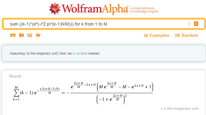

Symbolics is not the strongest part of Mathcad and so you may consider using Maple or Mathematica instead for more complicated symbolic calculations.
Also the free online Wolfram Alpha might be an option:

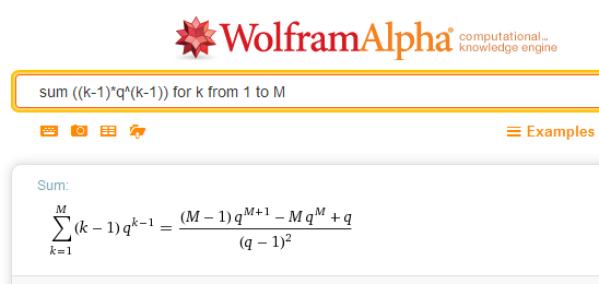

Here is a different approach which displays the result in a different manner
June 19, 2016
Concerning the name of the series k*q^k.
I guess there is no special name. its just a variant of the geometric series.
You sure will find a lot of links where it is shown how to derive the closed formula for it
Power Sum -- from Wolfram MathWorld
https://de.wikipedia.org/wiki/Geometrische_Reihe#Herleitung_der_Varianten
Forum "Folgen und Reihen" - k*q^k partielle summation - MatheRaum - Offene Informations- und Vorhilfegemeinschaft
