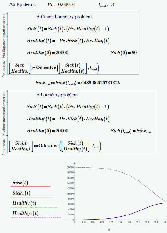

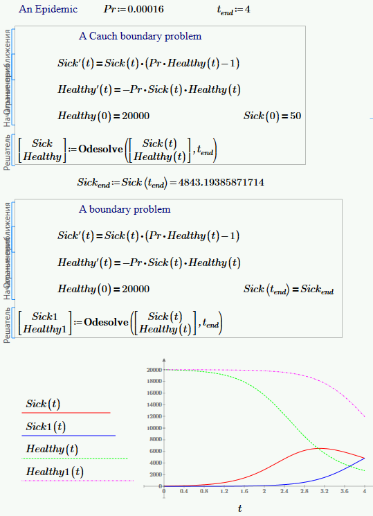

Mathcad 2000 with odesolve can solve only one ODE- a Cauchy and boundary problems.
Mathcad 2001 can solve a system of ODEs too - but only a Cauchy problem.
But a boundary problem of ODEs with big error! Mathcad 15 and Mathcad Prime too
See please - t.end:=3
and t.end:=4
