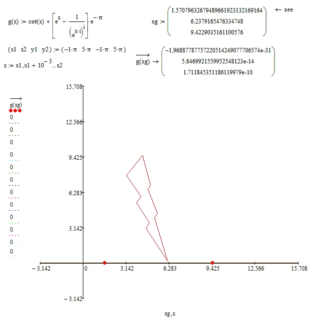

Hello Everyone.
From :
I.PNGA Reason for a missing-point ?
Thanks in advance.
Regards.
Loi.
12 replies
November 3, 2018
Again and again and again and again ....
You always run into numerical inaccuracies! You cannot expect a 100% exact result when using the numerics with its IEEE format and its limited about 15 digits precision.
The numerics in your case thinks that the first value is non-real and so it is not plotted:
In the meantime you should already know what to look for and be able to find out things like that yourself.

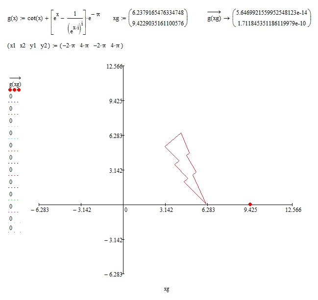

November 3, 2018
I guess I don't fully understand above that, but a number with 30-decimal-digit It did show the point. And again : " I guess I don't fully understand above that " :
II.PNGBest Regards.

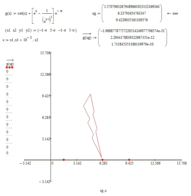

November 3, 2018
Oh... so far I guess I somewhat understand about that, now the point to be shown but now I need help with a explanation.
III.PNGBest Regards.
