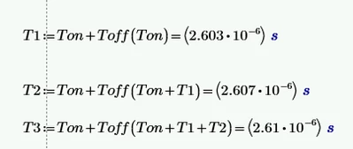

Hi all experts
Hope you could do me a favor.
How could i express the following series order with programing function?
Tks
Ton is the constant value and Toff(t) is variable by having different "duration" Ton, Ton+T1, Ton+T1+T2

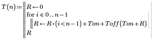

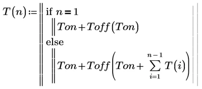

You may try a recursive approach either using he if-function
or the if-statement

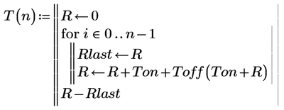

And here is a non-recursive approach which should be more efficient for larger values of n
We can get rid of the local variable Rlast but have to treat n=1 as a special case and so have to use an if-statement

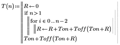

We can also hide that if-statement using a boolean factor
