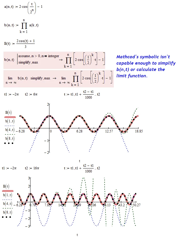

Jul 4, 2025 8:56 PM UTC
After playing around with the problem a bit, I now think that you forgot to enter a summand -1 when you provided a_n, right?
That would make the limit function correct and, as I suspected, Mathcad's symbolic does not succeed in either simplifying the product nor in calculating its limit.
But at least we can 'show' by plotting and visual inspection that we seem to have a rather fast convergence:
And yes, I also think that it is indeed quite a difficult task.
Jul 5, 2025 4:31 AM UTC
Yes, the "-1" was forgotten - sorry.
