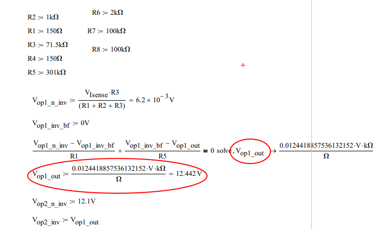

Hi, All,
I have a question about  solve equation,
please check red circle as below,
I've defined Vop1_out at solve equation,
why I need to define it  again?
Is there have method to solve this problem??
Thank you all guys
Yes.At the far left of the region where you solve type  ":" followed by "v.op1_out" (all without the quotes.
That way you have already assigned the variable the correct value. To prove it, evaluate the variable somewhere below by typing "v.op1_out="
Example:
Note, that Mathcad's symbolics does not know anything about units and Ohm and kOhm are treated as two different variables.
Evaluating the variable numerically gets things sorted out.
