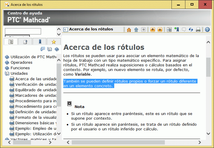

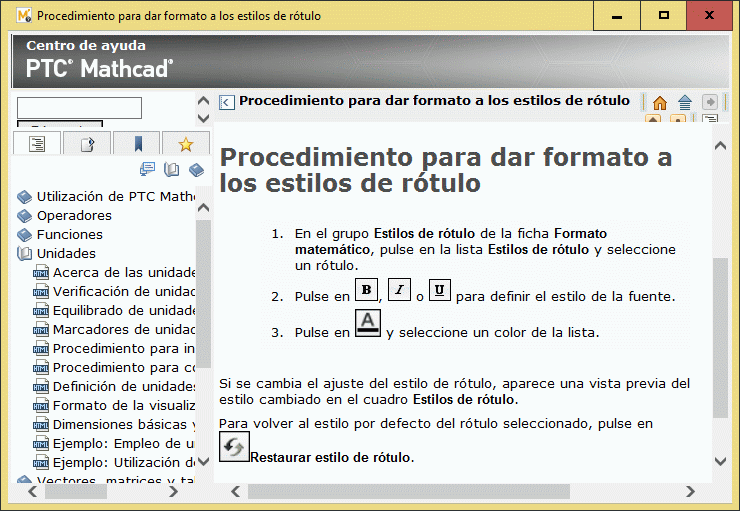

Can't find the "how to" do for this two simple questions:
1. How to format a label, from this help page:
2. How to create a new label, from this other help page (blue highlight says that "You can also define your own tags or force a different label on a particular item."
Thanks in advance.
Alvaro.

I guess that the help was poorly converted from Mathacd 15's  help in great parts and at some places so the help simply does not apply. As far as I know we cannot create user made custom labels in Prime.
Werner
Werner_E25-Diamond IAnswer
Werner
Hi Werner. But this is Prime 3.1 ... and ... . Ok, ok. I see. Thanks.
Best regards.
Alvaro.
