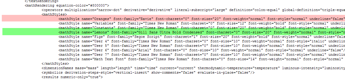

If you need this feature regularly, you could write a program/script which copies the mathStyles-section of one Mathcad  xml-file to another before you open the ,master document in Mathcad. Still awkward, but the only solution I can think of and you have to decide if its worth the effort.

You could use a text editor to arrange the appropriate lines in the *.xmcd file (don't save in compressed format) so they have the same order as in the other file.
Mathcad just assigns a style number to a variable  and so the order of the styles is what matters.
