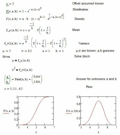

Thanks a lot, but i want it using MathCAD codes
March 28, 2020
Usually we like those we are trying to help to attempt something  first.  All you need is to enter the formula and use a solve block.
Just this once.I'll do it for you in Mathcad 15
