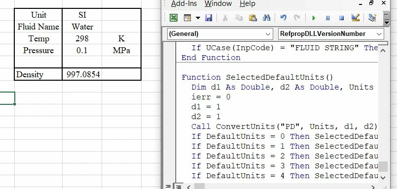

Hello Community,
I have been trying to access Refprop (Excel add-in) from MATHCAD Prime 6.0 through Excel Component. My requirement is Excel should take the input from MATHCAD and will paste the output generated in Excel back into MATHCAD. While executing, I found that it is writing the input in Excel given through MATHCAD but not calling the updated output values in EXCEL back into MATHCAD and showing the error. Later on, I found that it is entirely removing the VBA code for the required property function that's why it is showing an error.

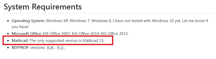

Can I get an idea that how can I tackle this problem? or Is there any other way to integrate Refprop in MATHCAD?
Could you please help as it will be part of my project?

This is what Excel component in Mathcad Prime does without additional add-ins. Am I missing something?
Once again, I am not sure I understand the problem but the following information might help to sort it out. When you create and Excel component in Mathcad Prime it creates a new Excel workbook without any VBA script in it. After that you can try to activate Excel by double clicking the Excel component, show the "Developer" ribbon tab in Excel if it is not visible and edit the VBA: add the scripts that you need. I can't guarantee that it will work as you expect, but this is what I would try.
