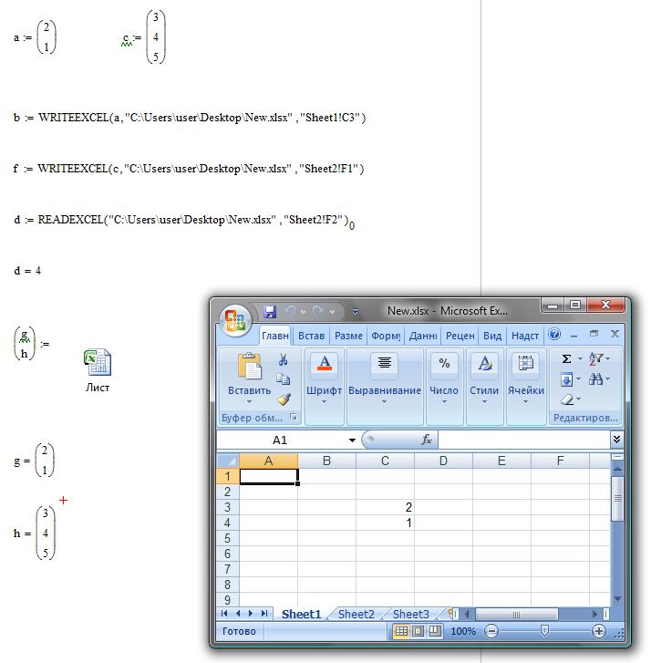

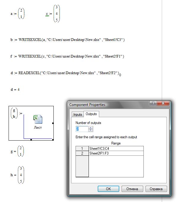

It is necessary for you to use additional record in a type "Sheet№!Cell".

As Vladimir has shown above, there is a built in function which allows you to call up individual Excel worksheets. The only issue is that you have to know the worksheet names.

I forgot to mention that I have recently produced a scripted component which will automatically pull Excel worksheets names which could help.
Search under my name - it was Raiko's thread.
