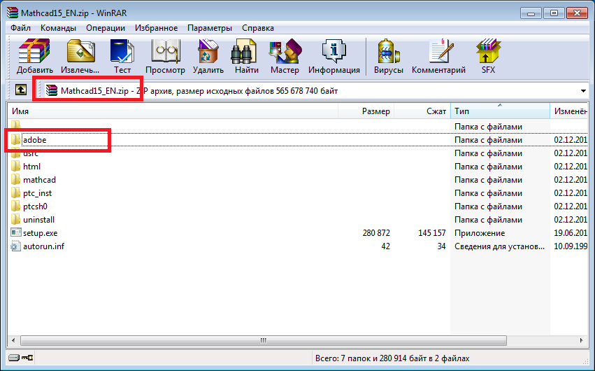

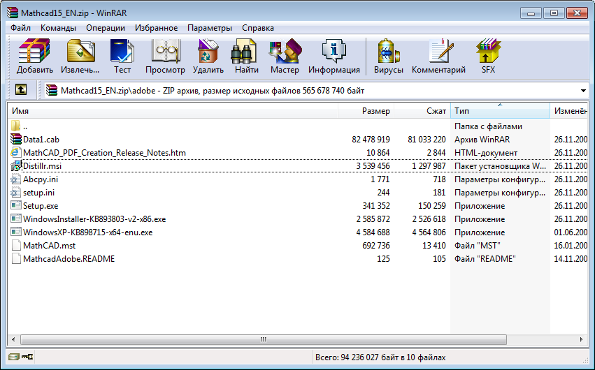

You can find "Mathcad PDSi viewable support" component (by Adobe Systems) in the latest Mathcad 15 M045 package, here: Thank You for Your Interest in PTC Mathcad 15 | PTC
rlydon1-VisitorAuthor
July 6, 2016
We've got this package, but running the distillr.msi or the setup.exe gave us an (I'm paraphrasing here) "you cannot install this standalone, the addon must be selected when installing Mathcad" error.
We've found a way around it, more detail in the response to Richard.
